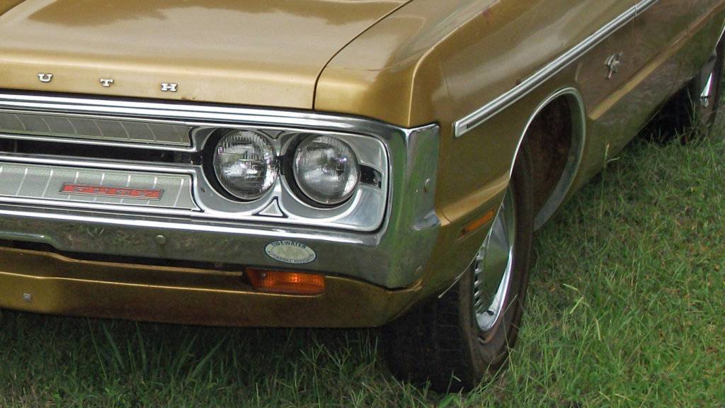

Used grills and head lamp bezels for your car are fairly common. Suggest you shop eBay and this site for some nice used ones that still have the applique's in place (they are actually metal, not decals).
Isn't it just Argent paint with a black stripe?

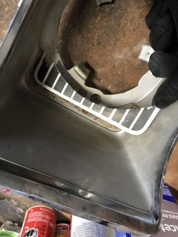

I need to go through the same type of detailing on my 68. They are a small tin/ Aluminum sheet that has been run through some stamping die to form the ridges. Then it is painted trim black. It at least seems to be a satin black. I had to use a heat gun to pull it off the grill surround before I took it to get chromed. I have a few months to get some of the rock dings out and practice detailing with my spares.

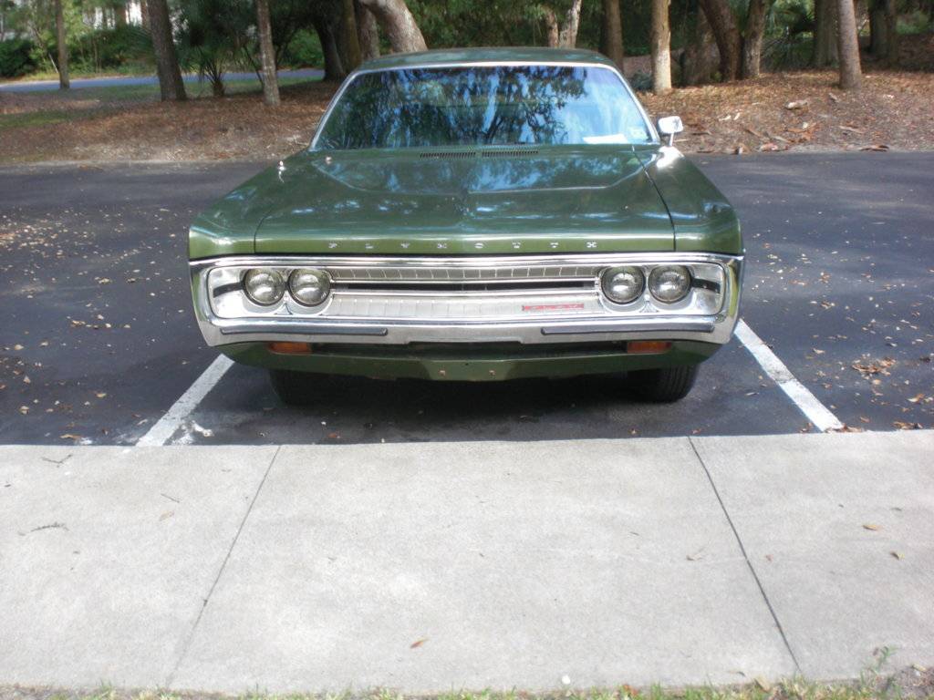

Thank you both, on '71 Fury's that texture outboard of the headlights absolutely is stickers, I did not realize they were metal. Do you know that to be a fact? The eBay grills for sale, most say "stickers missing," or "3 of 4 decals missing," etc. in the description. In photos they do look like metal (that was the goal I assume.)
The '71 Furys you see mostly are like mine, I just polished the aluminum, and I can paint the black outline, but it would be cool to have the grill texture the way it came off the assembly line, if anyone has seen or heard of how it can be done. On BobK's Fury there originally was something there but it is missing on his too. I would prefer not to spend $175 for some headlight surrounds off eBay in nice shape only to have those stickers fall off/fade in time.
