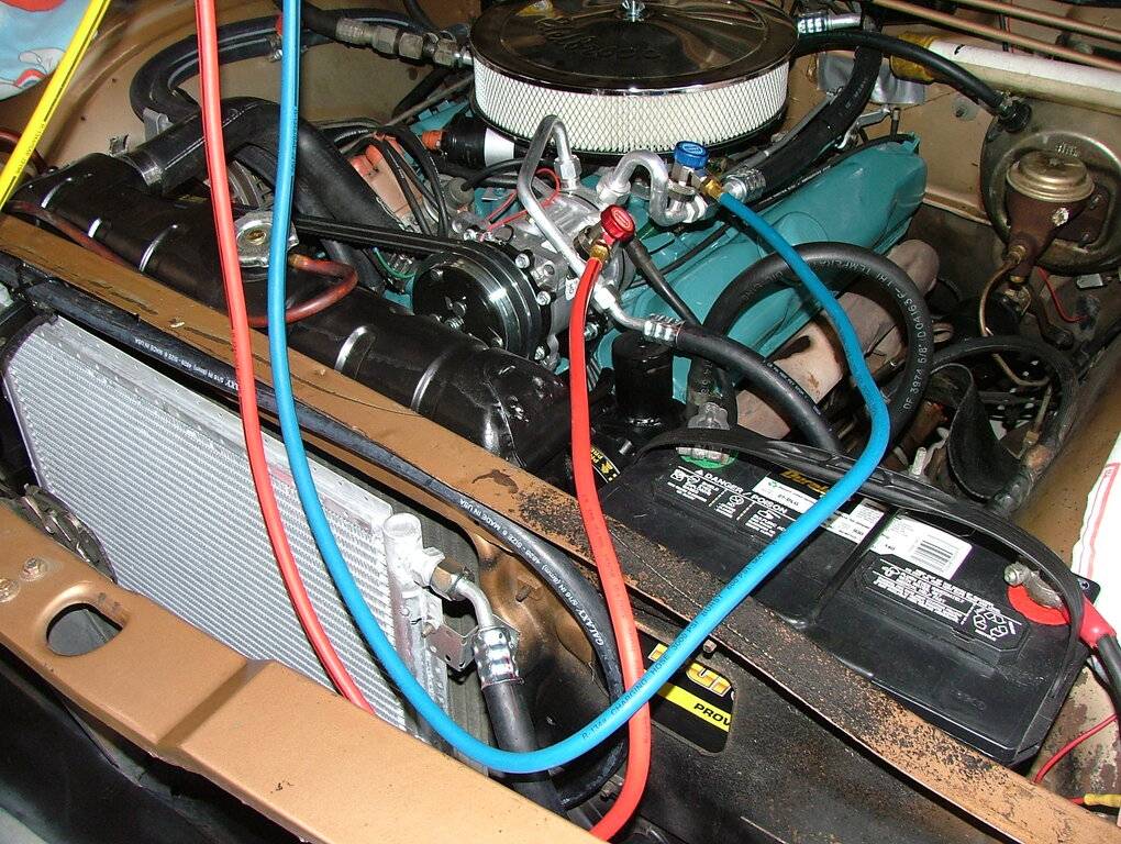

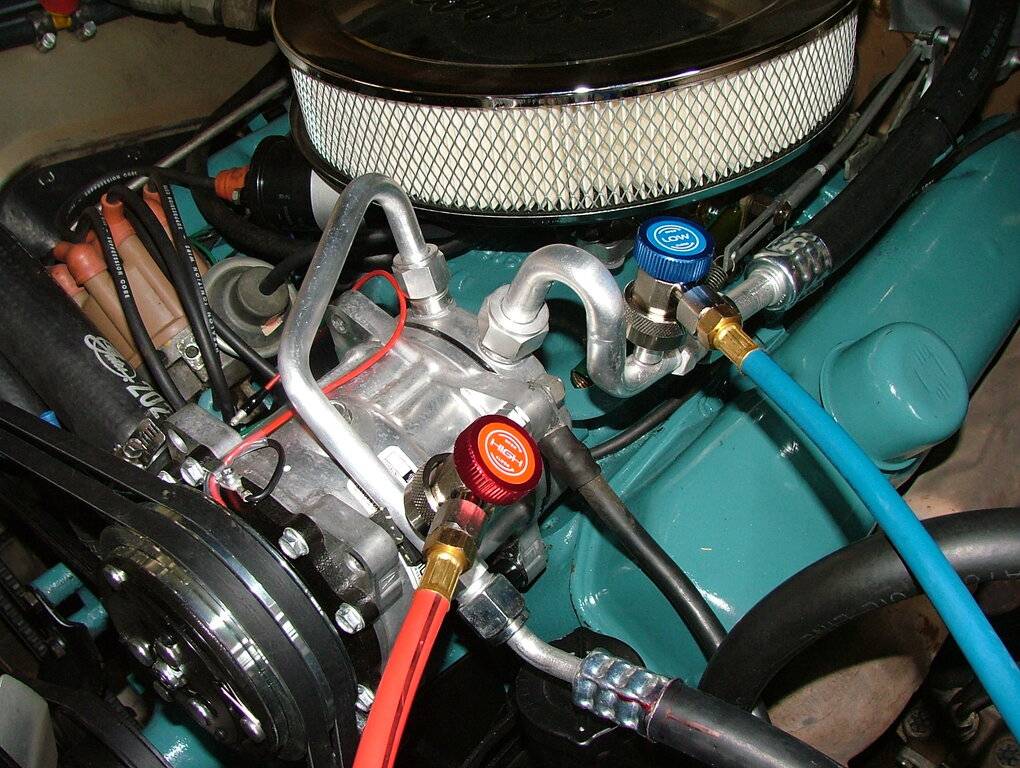

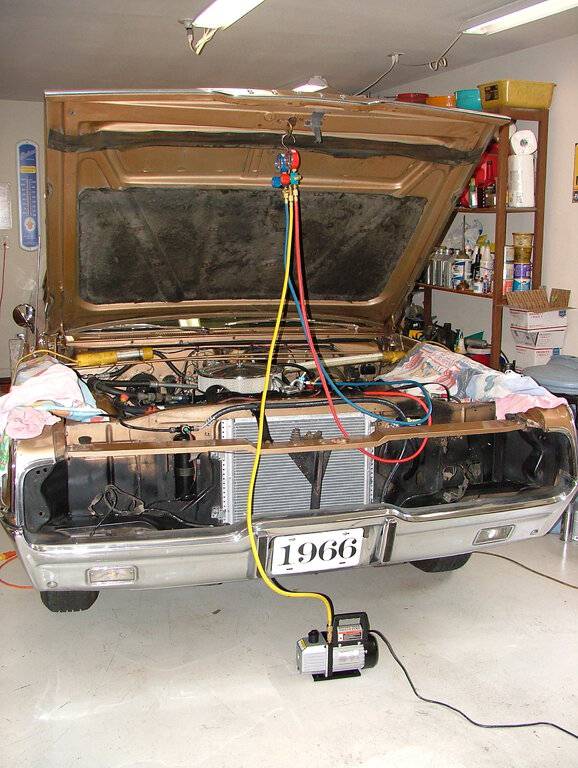

I agree with #John Kirby and others, you will be much better off doing an underhood conversion to R134A including new Sanden compressor and modern condenser. I did a LOT of research and did this successfully on my 66 wagon with dual A/C and it still works after two Texas summers. Here is my thread, check it out.

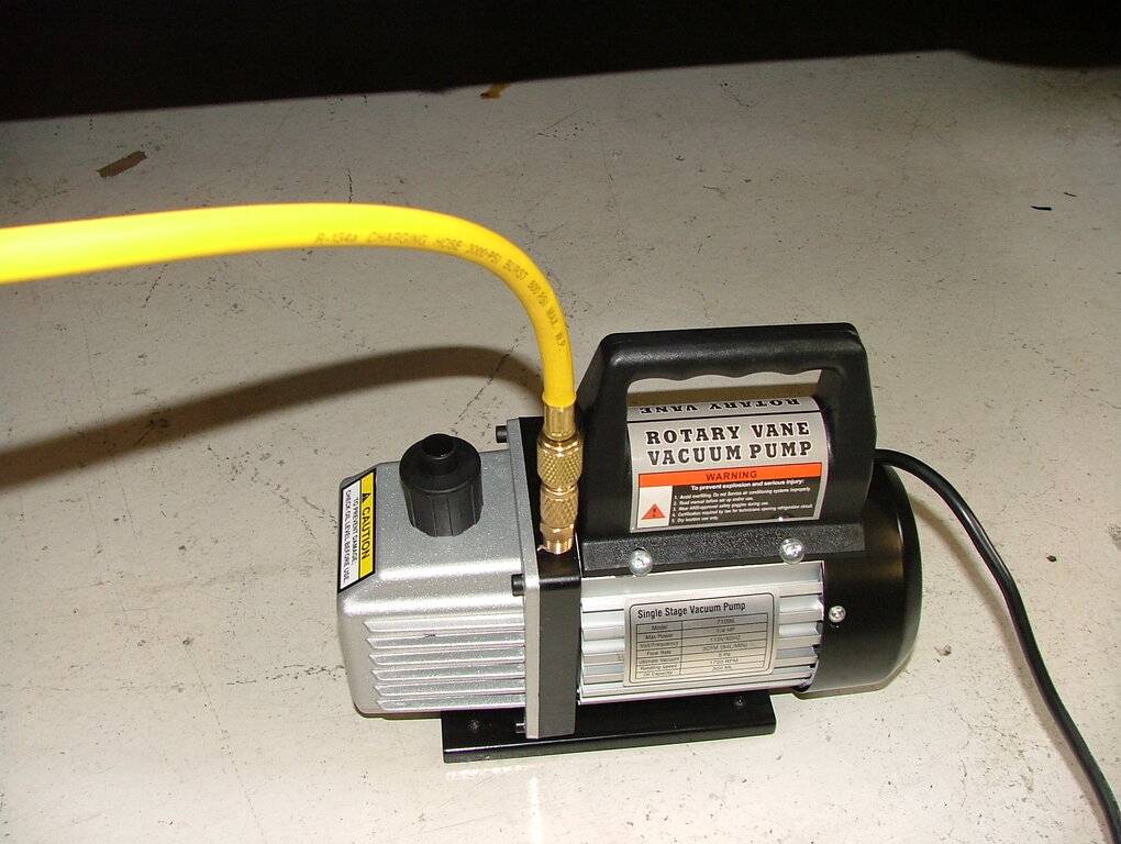

2. My plan is therefore to ask my local classic car mechanic to draw a vacuum on the system before anything. Spin the compressor clutch by hand to be sure the seal is good. Then he can recharge.

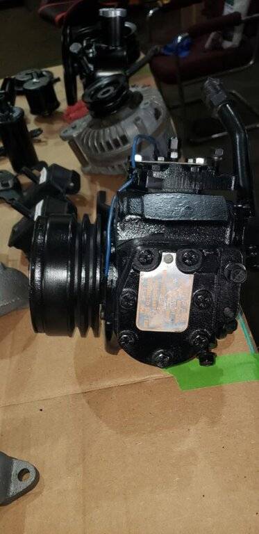

Put differently, because of what we learned from the LZ AC shop last year, our only concern this time around is the compressor. The new one pictured above is the last one Wyatt and I had on hand that seemed to be in working condition. I hope it is.
Thoughts?
Thoughts?

The compressor that you have on hand will work fine, if it doesn’t leak. Capacity-wise, I have followed the advice previously posted. The first thing to do, is to make sure that your system can hold a vacuum. The seal on that compressor might need to be replaced, and a vacuum test where you pull a vacuum and have it hold overnight or longer is the first step. Once you get that done, then you can put in a charge of R-12. You should see results after about 1-1/2 to 2 pounds of refrigerant. For R-12, the site glass is a valuable way to indicate how your system's performing.

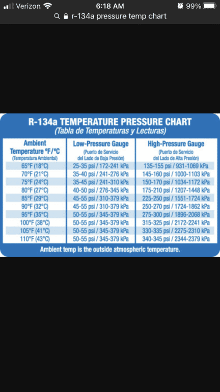

Another teaching point regarding R-134a is indeed that refrigerant is better measured by high and low side pressures, driven by the outside air temperature. I have used the chart below for Mel, the 1995 Buick Roadmaster recently and nailed the charge using it.

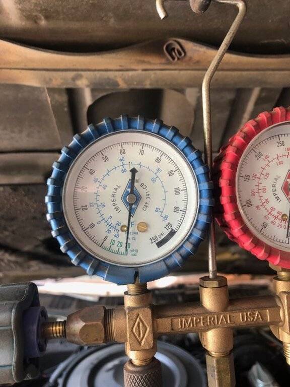

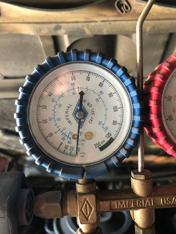

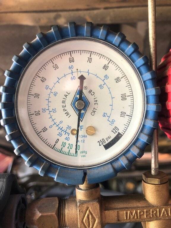

Thanks guys for the advice. I am happy to report that the system holds a vacuum -- here are the readings yesterday at 11AM when the test was started, 3 hours later, and just now.
24 hours later 20210607 64728009903__E63CF66A-69C2-4855-B10E-9FC0DA65F070.jpeg
Last year, with the original A/C compressor, the Lake Zurich specialist showed @71Polara383 that he had the vacuum drawn and it was holding (good) BUT when he turned the AC clutch by hand, Wyatt could hear it start leaking (bad) -- he turned it some more and the leak stopped. He recommended to replace the compressor, which we did thanks to a donor car. For this reason, Wyatt recommended that, with the new compressor in place, my local technician turn the A/C clutch by hand and see if it makes a difference. Happy to report that there is none, so it looks that I am all set. Charging will start soon.
