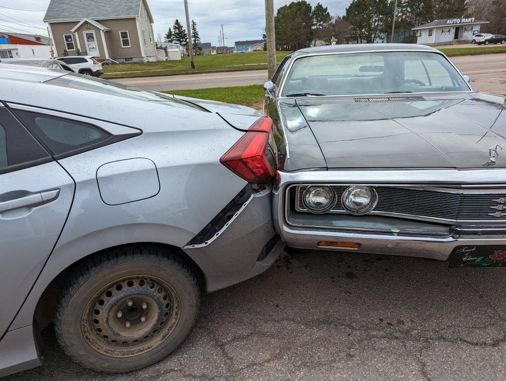

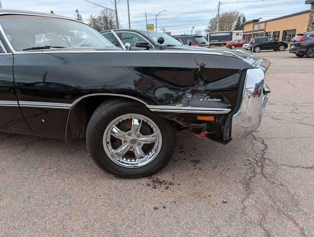

How will my insurance company find parts for this...
69 Newport base fender 1 year only with small reflector.
The 69 300 parts car fender is different with the optional cornering lamp..so no go on that too.
69 New Yorker fender will work but need minor mods to delete the tabs for trim clips and/or fill holes from the extra trim
70 fender sidemarkers different location.
Hope this helps.

I good body man should be able to knock that out, all too often nowadays they just want to replace parts. send the bumper and trim out, plenty of places doing those.
Check the grills and bezels for damage.
I think the fender is well within the fix and not replace.
I was expecting worse.

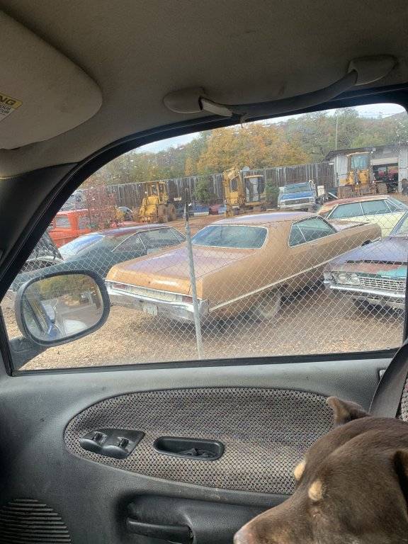

The fender your looking for is on this 69 Newport coupe. With all the trim holes,side markers etc. in place.
The car has no motor
trans or front seats and was a high back bucket seat car originally.
I’m not quite sure,but if I remember right it was either a 383 4blb or 440 car?
Restorable or parts.
The yard is located in Kelsyville ca.
The contact info is
Kelsyville auto wrecking
707 279 2123
Ask for mike
He may or may not want to sell just fender. He may or may not want to ship fender?
He will usually will sell me a whole car like this for &500-$1000.
Only photo I have.
I will be traveling in that area soon and can ask him about him about fender
Hope this helps.
My 69 300 vert has only the small reflectors. Made after Jan 69 only got reflectors.

New cars make it impossible to see aft from the driver's seat. The view consists of oversized headrests and a high horizon line formed by the trunk in between. So yeah, maybe the reverse TV screen was out?
That Honda driver should trade their car in for a Newport and they'd be able to go in reverse all day long....
For as small as they are, new cars might as well be cargo vans with respect to rearward vision. (Front and sides not much better.) I’m guessing that the reverse screen was working just fine but the driver’s brain was out to lunch.
