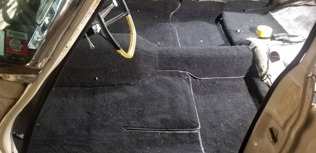

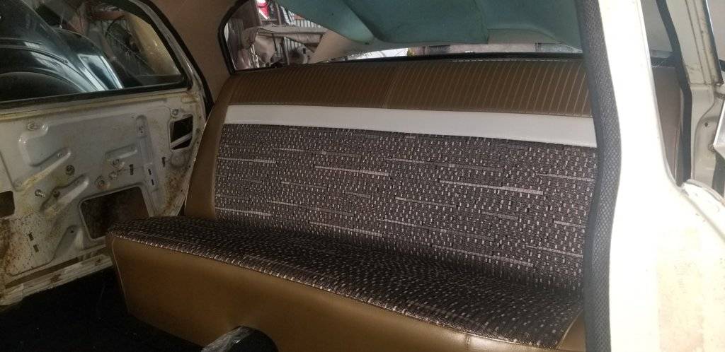

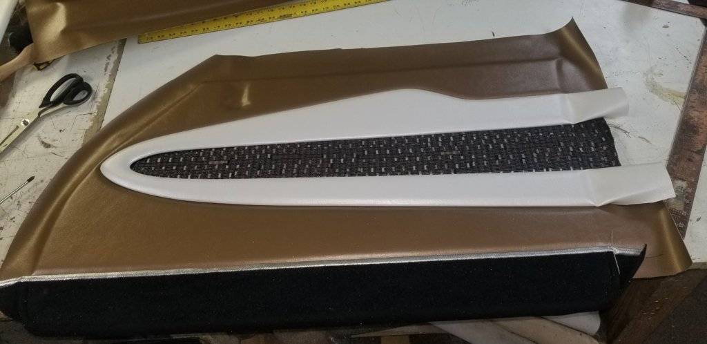

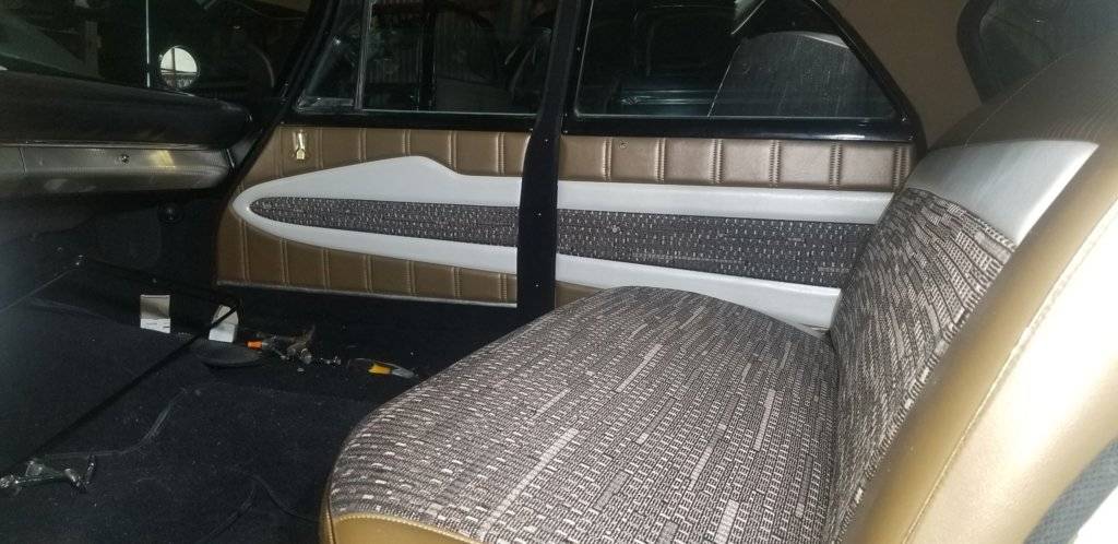

I haven’t really driven the car much and now it is in the beauty parlor getting a new interior. I can’t even go check! The guy has a Covid fear and doesn’t like me dropping by. But he sends pics! Included below.It's been a couple years. How is it holding up?
