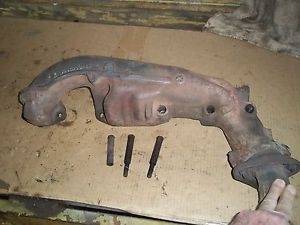

The passenger side will fit no problems. The driver side needs a little work for clearance.
Most Formals from 75 on came with the late version high flow manifold (You can tell by the high swoop from the front exhaust ports) as standard on the drivers side in order to clear the steering box. So you may only need the passenger side anyway. They are not as swoopy as the earlier versions, but they flow well and are way better than logs.

I concur with the interior volume increases on the formal cars' B/RB exhaust manifolds. Chrysler had been seeking to make their engines "better air pumps" for several years, so these larger cross-section exhaust manifolds were one part of that.
It's possible, as on the earlier HP manifolds, that differences CAN exist in the clocking and angle of the exhaust flange, from model year to model year, much less if they came from a B-body or C-body.
