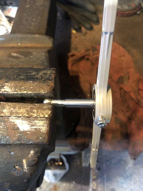

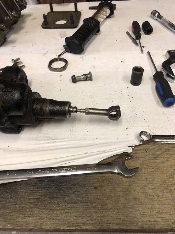

Started the hydroboost mod on my friends 69' 300.

I went to a local auto wrecker and pulled everything off a 2000 gmc duramax, I got the booster,master cylinder,all the hydraulic lines and power steering pump for $150, but I'm making new lines at my work and putting AN fittings in the booster, also I flipped the booster upside down for more clearance, and all the lines will go from the bottom now.
