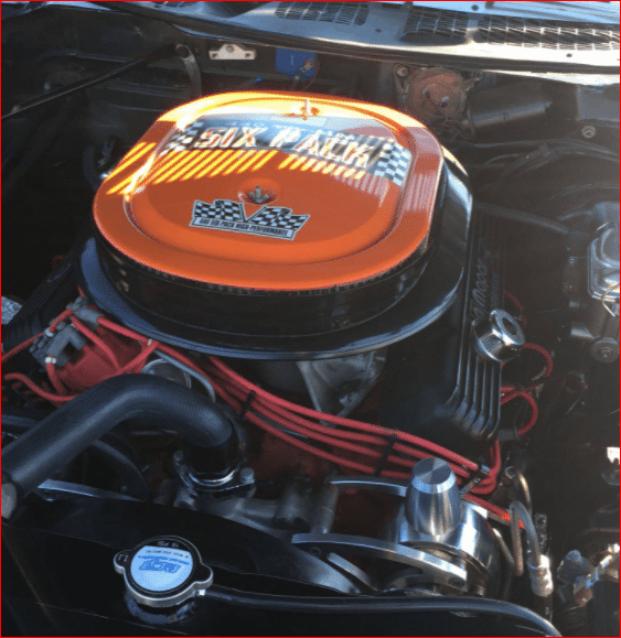

I cant disagree with those that say you can get the horsepower other ways easier and cheaper but....they are cool. Here is mine. Previous owner put it in, thus he spent the $. From an engine builder using new reproduction parts. With help Im making it run right. Gotta an older guy helping me as I make changes. When the outboards open it does make you grin.
Hood clearance about 1.5", now .75" with phenolic spacer.
Headers, 3" exhaust, cam, TCI trans, electronic ignition, 5/16" fuel line.
I don't mind the challenges but probably would not spend the money again. Although the 6bbl efi kits are whispering my name.

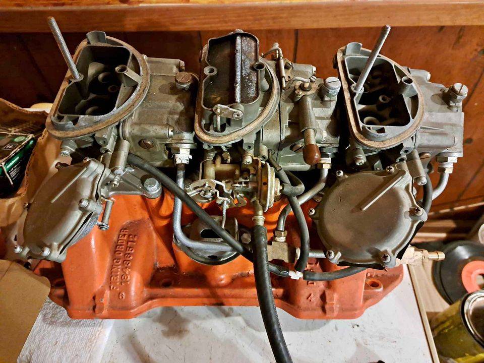

Thanks for posting this. I'm hoping my 69 300 has similar clearance. I'm just going to try it to see what it looks like. I've had a complete setup on my shelf for a while now.
(Yes I have a new style AC compressor to bolt on too - was doing that regardless.)
Let's see how it looks with a turquoise manifold and a "Commando" sticker on the air cleaner top. If I can close the hood I'll at least get the bigger exhaust manifolds and add dual exhaust. Fun, fun.
