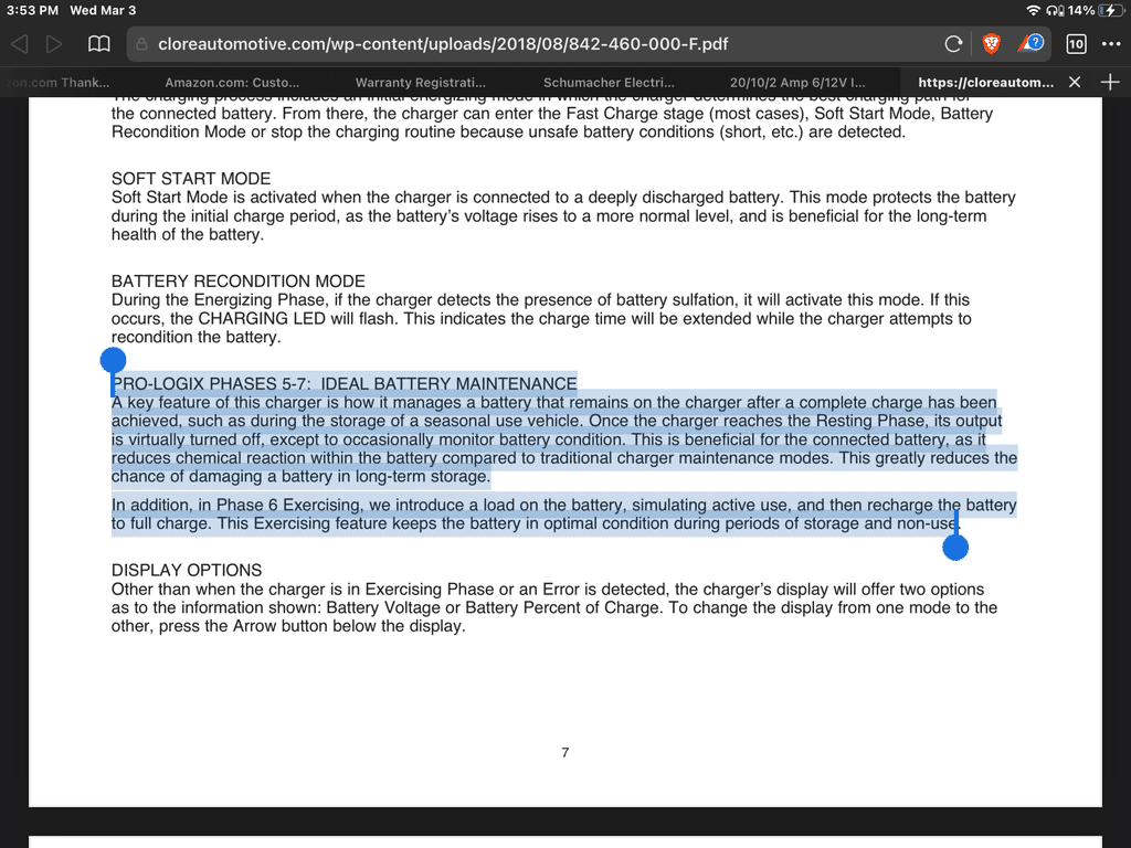

I pulled the trigger.
Found this in the owners manual
That's a good price point too.
