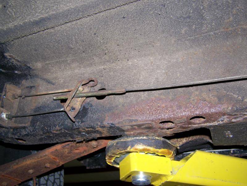

I still need to look at these rails on my current car
closer, but am expecting the worst....
Tough to tell from that photo but I was referring to an in general not that specific photo
look at the trunk drop downs. lip, and above/behind the lip on the rear wheel arches. crimp of the door skins around bottom insides of the doors. bottoms of the front fender braces inside the door jambs. bottoms of sub frames should be basically flat, square. if they're stuffed in from jacking they're weak. areas near chrome trim on sides of car. trim wears through paint. surfaces rust from behind trim. i could fill this whole page. the car in your picture looks familiar. from the hartford area?
just read through all your past threads. yep, same car. i thought about it. would have been easier to purchase that one than fix mine. lack of a/c killed it. too bad that you don't have mechanical skills. your car looks solid enough and the mechanical repairs would be easy. rear window glass is a kind of a deal breaker though. was told by an old hand that the window curtain is supposed to be unzipped before putting the top down. i don't (too lazy), but am very very cautious those last couple of inches. tough decision on that greensboro car. might be better to just keep your powder dry. SG
