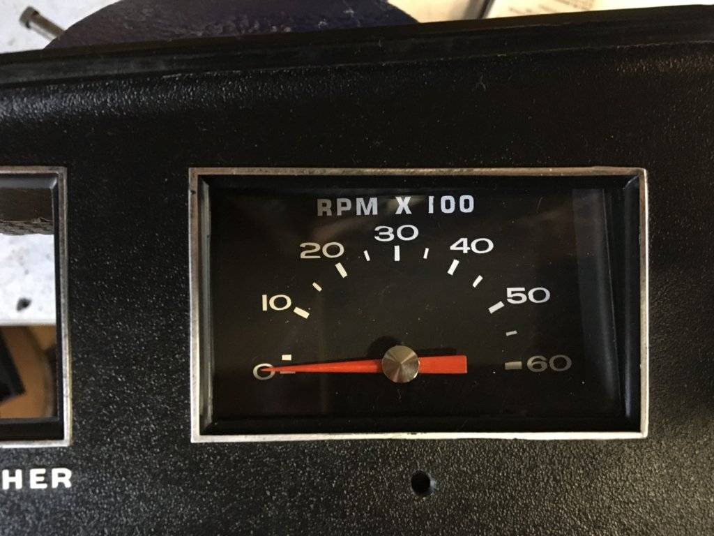

I finished building my 69 fury dash Tach today
Well I guess anything is possible but for now all I can do is tell you how I did it. The stainless steel button on the needle was a real pain in the butt to find. I had to buy a house clock and remove it off that. My wife was none to happy about me parting out her new wall clock. Lol

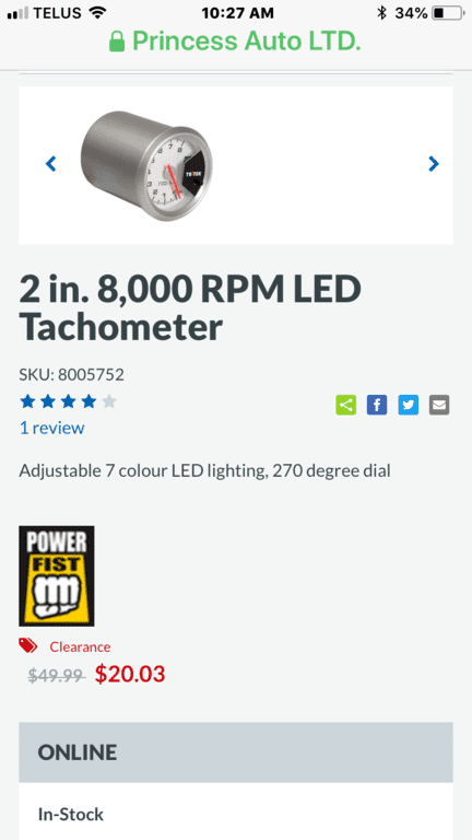

I used the smallest tach I could find at the time it was a 2 1/2” Tach. Since then I found this 2” tach and that’s what I would recommend.its smaller and easier to work with. The needle sweep is correct for the 0-60 sweep. You just mount it with a bit of a turn till you have the proper sweep start. I don’t worry about going over 5,000 rpm let alone hitting 8,000
I’m not wiring up the lights inside the tach because they are not needed. I want to use the original dash lighting that shines down onto the gauges and switches. I want to keep all lighting original, with working time delay Courtesy light And the main dash lights.

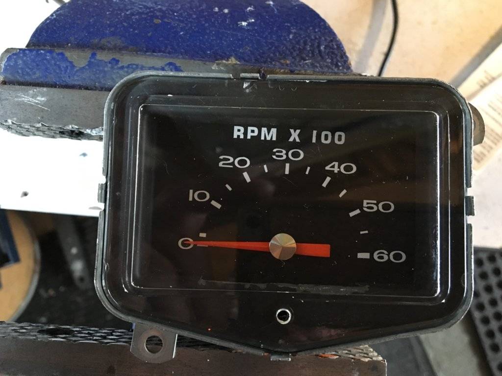

The top picture is of an original Ma Mopar tach. The next 2 pictures are of the Tach I made. I polished up the clear lens with the same optical grade rubbing compound I use on my paint . It works extremely well on plastics such as gauge cluster clear plastics , signal light lens and tail lights lens

First off I want to say thanks for the compliments and encouragement ,it means a lot coming from like minded individuals. I never thought of mass producing these tachs but one never knows where life may take them. The graphics for the face and the needle can be manufactured with relative ease now that I have had it done And that’s the start of the recipe !The hard part was mounting the tach on the back of the clock about an inch lower than where the main clock body was and doing a professional job That everyone would be proud to own. I’m not totally there with that part yet . My tach is good enough for me but I don’t think it is for paying customers. The next part is the 2”Tach. I was only able to source 2 locally for $20 each both of which I used. Then believe it or not was finding a suitable stainless or chrome button for the needle , I would be sleeping in the garage for the rest of the summer if I parted out all my wife’s wall clocks for the center button on the clock face. For me I take on these projects in the winter months when I have the time , beer and patients. When our short summer arrives I’m Outside soaking it in. Family and work have a way of side tracking good intentions. That being said I have no problem helping someone convert a clock to a tach. Ideally a 3D printed adapter plate from the tach to the back of the clock body is what’s needed for a professional job , it’s the missing link in my opinion. If I owned a 3D printer then it would be easy to make an adapter plate. For now I’m going to say i’m Not mass producing them YET but I will help anyone who wants to do the conversion the best I can.

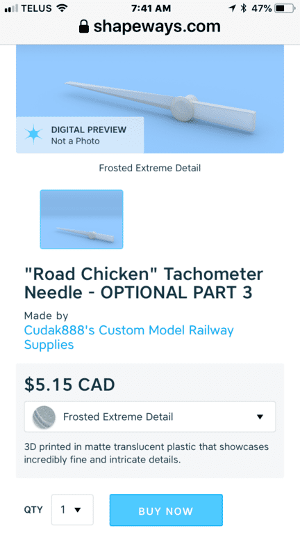

Here is a picture of the outfit that 3D prints the tach needle. I thought it was great quality at a great price. You have to forgive me I don’t know how to copy and paste address and such yet on a phone or computer, I just know how to take pictures and work with my hands
They produced the needle fast and had it to me in 4 days. They are also working on some other Mopar tach backing plates just not the one I need because I don’t have a pattern for them yet.
