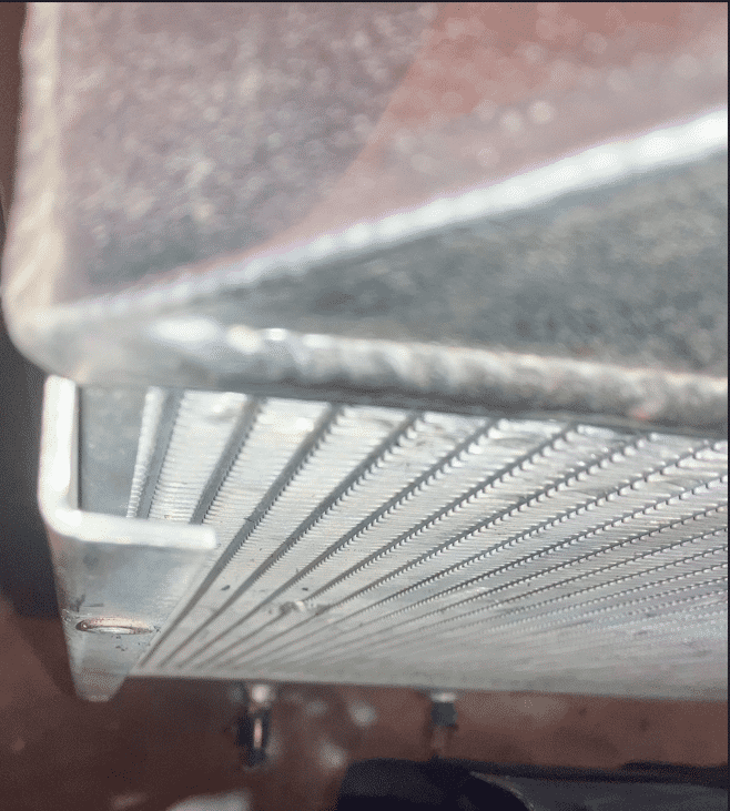

Have this 26-inch cooler that came with our '72 Fury. Wanting to know who the supplier is. No marking on it. Fits well with no modifications and functions fine. Uses factory molded hoses (360). Trying to track down supplier so can see if a shroud is available for it. OE shroud does not fit. Guessing it may be an older Champion. 72 Fury with similar listed on FB recently. Any assistance would be appreciated. Thanks.
Looks like one I just purchased from Rod Davis here in Phoenix based upon the style and the brackets for a shroud. I am in the process of installing! For a shroud, I am taking a sheet of flat aluminum and having it bent, hold cut and then it is bolted to the brackets you see in the picture. I also have a friend who has the exact same radiator who purchased a two piece universal, split shroud and then cut to fit. Talk to a local machine shop if you want to bend to fit or purchase a universal two piece and shape as required. My friend is running the same clutch fan you have as a set up. I personally am installing dual 12" Pro Form brushless fans which together move 4200 CFM. Both of us moved from the 22" x 18" core radiator to a custom 26" x 18." Phoenix, 22" x 18" to light!
