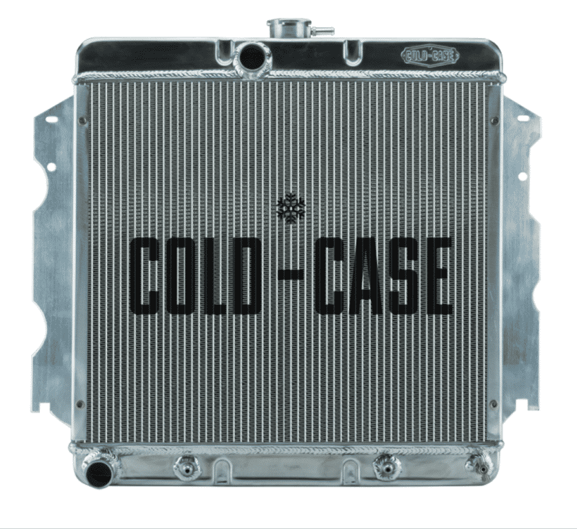

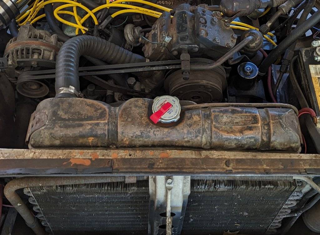

I have perused the Cold case website but seems like there is no update on a direct drop in install radiator, only choice to go with is a MOP753A, I would have gone with the MOP751A but I have A/C, so if I attempted to install the MOP751A the centrally located upper hose would bump into the A/C compressor low/high side Schrader valve.
See below for the photo and reference off of the MOP751A, and see why this would not work.
Hoping Cold case will accommodate an 18 inch tall & 22 inch wide core with the correct offset upper hose inlet as Gerald Morris has mentioned.

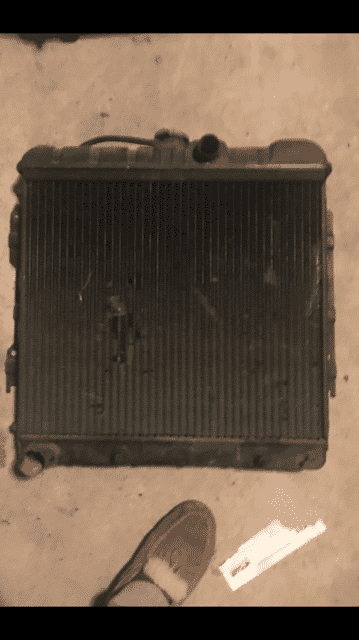

The radiator in my 64' Dodge custom 880(Chryslers forward look design car) has started leaking from every orifice possible.
Texas summer's are just brutal on the radiator, creeping up on 205* in Dallas traffic.
(Few days ago the outside temp hit 110F*)
