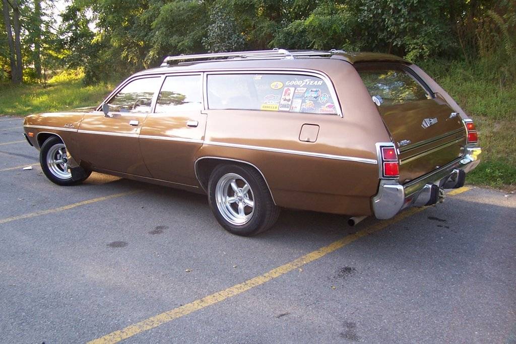

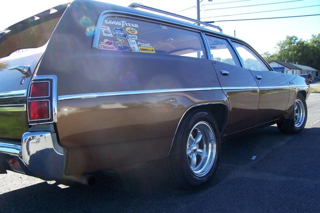

Not a C but topic related...
My 73 Plymouth wagon came factory with H78-14. 27.6 OD. Today's radial equivalent is 22575R14 27.3 OD.
Nobody in the broad market tire business makes it anymore unless I run trailer tires (which is not a good idea and somewhat illegal)
I did 23560R16 27.1 OD on 16x8 wheels with a Zero offset.
Perfect fit,still shows some sidewall and speedo is out by 3 tenths if a MPH.
My point is with a bit of homework, you can put on modern day wheels and tires that will still look good and not be out of place.

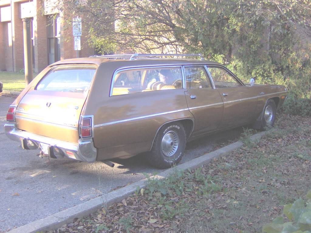

I ordered a set of these wheels in 14×7 size for my '68 Fury VIP, I ordered them through Jegs, I haven't received them yet.
Are you the original owner? Does the fender tag call for the all chrome Magnums or the trim ring Magnums or wheel covers?
Build sheet code is 580, which I understand is for Chrome Magnum 500 Road Wheels. These are what were on the car when I bought it. SPD is 325
