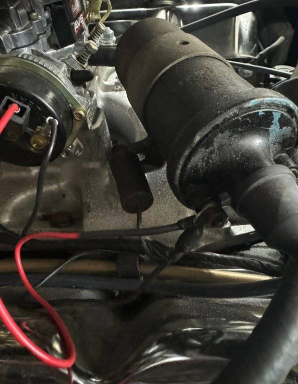

Trying to locate where the ballast resistor is. I’m agreeing this is likely the problem or at least an issue
I dropped the ignition switch out of the dash. Put the key on turned to start. Car started right away (engine is awesome) but as soon as I let go of the key the car stopped
This is old school points not electronic
I ordered a new balast resistor and a new coil condenser.
