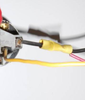

Hey went to change it out and noticed that it had an extra prong on it for a ground? The original one is 5 prong and tbis replacement was 6? Possibly wrong one?
Pictures would help of switch & your wiring to see if we're working with standard or cobbled.
It look sum'tin like this?
Yep that's the new one but the one in the car only has 5 prongs and not the ground . The top left grd isn't on the old one in the car.
IIRC it won't hurt. Seems to me I have an unused prong on my 65 Polara, think it's the same switch. Hasn't been a problem yet....
