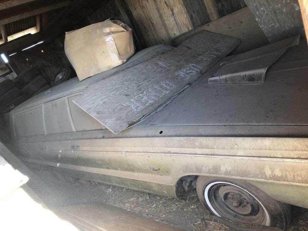

Inherited a 66 polara wagon

I also need to figure out how to get the rear hatch open, someone looked to have smashed a key into it and I’m not sure how it’s supposed to open.
I’ll post it also in the wagon section.
You have to get the glass down to be able to open the tailgate, and you have to hope the power rear glass motor is working.
If the key is just broken off in the lock you might be able to use a screw driver to turn it and get the power rear glass to come down...if it was the proper key. If not then you will have to hope you have a power rear window switch on the dash and that once you have a battery in the wagon that it works and the glass comes down. If this doesn't work then you will have to climb into the cargo area and try and get the interior panel off the tail gate and then get power directly to the motor and get the glass down.

The key is only used to lower the rear glass, it has nothing to do iwth opening/closing the tailgate. There is a latch on the top of the tailgate in the center that you use to relaease the latches on the tailgate. You can't bring the tailgate down until the glass is inside the tailgate.
Yeah, I got that part but I assumed that you had to turn the key to unlock the rear gate too, or that was an opening mechanism. The key hole is in a piece of trim but it wasn’t obvious how that moved or opened the gate.
