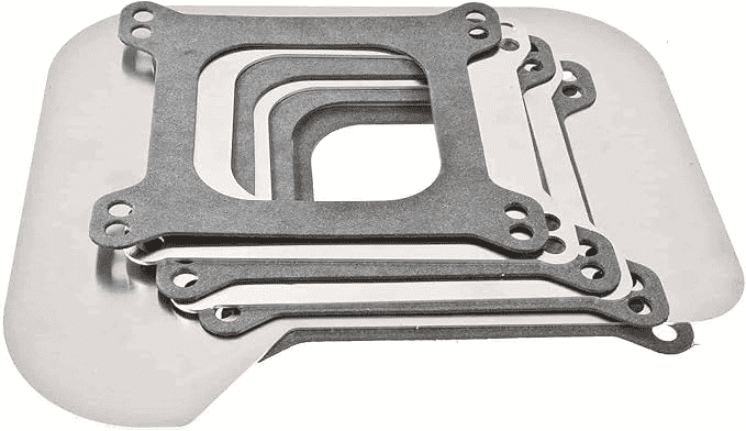

Do NOT use this type of spacer, period!!! I managed to crack the baseplate on an AVS, being very careful about cross-torqueing the hold down nuts, trying NOT to crack it, but it happened. So, the thick spacer with the plastic inserts for the studs is far superior to this 1970s attempt at "heat insulation".

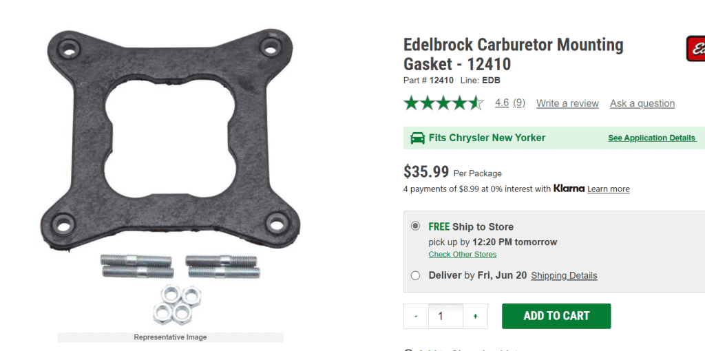

I stopped by Oriley's on the way home and they had this.
I installed it and reset a few adjustments. It is raining here, again, so I will have to wait for a nice day to give results.
Hmmm. I had no problems on my Blazer with the Edelbrock 600. Been on there for a couple of thousand miles.
As EACH of the intermediate gaskets in the aluminum/gasket "stack" are compressable, uneven torque can happen. The plastic bushings in the Edelbrock 12410 gasket do not allow that. Works just as well, if not better.

I think this gasket helped but does make a small whistling at part throttle low speed.
I did also make a bunch of timing changes that REALLY helped.
