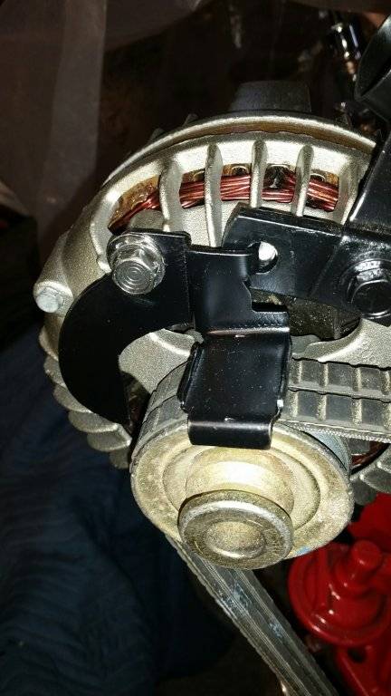

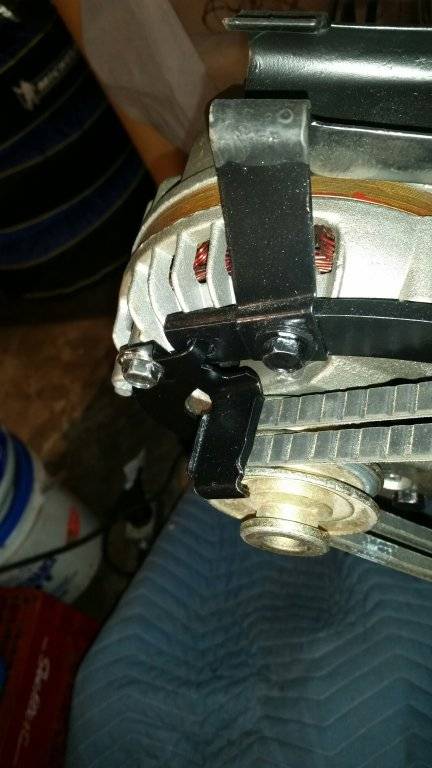

I would do it in an instant. I can't live without AC, but that's just me. In regards to the manual transmission issues, I would put a belt keeper on the alternator pulley to stop belt throwing during hard shifts with the AC compressor engaged. I made my own and I hope that it works OK.

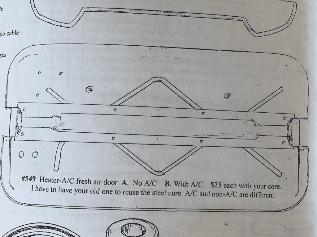

Another potential problem is the hole in the firewall for airflow is different for AC and non.

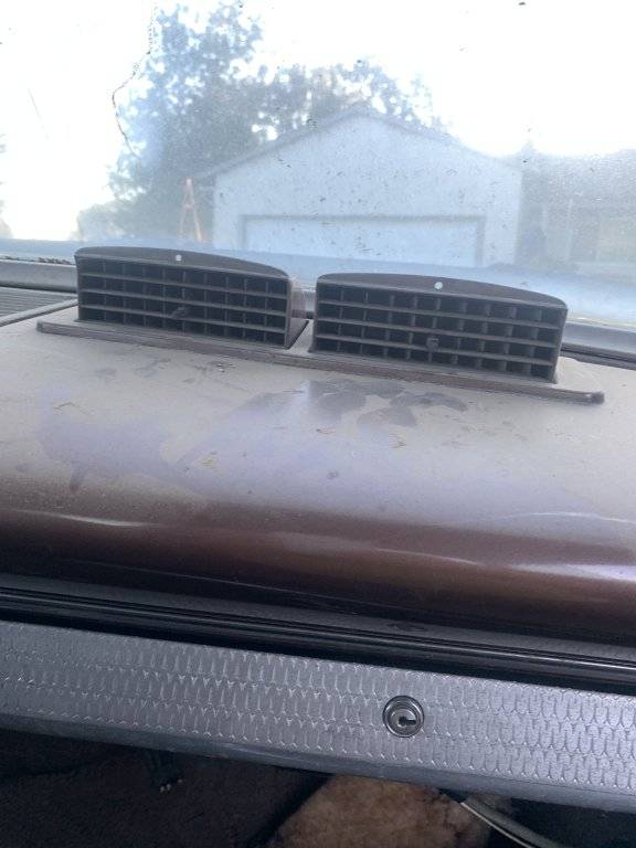

IMO, skip the AC (you aren't desiring it), swap the dash to correct the hack job, you'll have AC vents being dormant. Unless the unused vents bother you, that solves all your problems/questions?

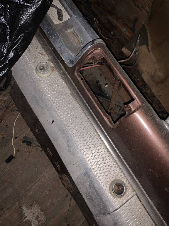

It’s the hack radio hole that bothers me.
Every time I look at it!!
I’m thinking the easy button short term solution will be to cover radio hole with radio delete panel.
You state you don't like AC on a 3 speed or AC in general so skip it. Many want AC these days so it will increase car value to those folks.
They look to be the same firewall on 60-64 dodge/Chrysler/Plymouth? Are the box holes different? Sizes?

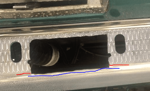

I wonder if an aluminum plate could cover down at the bottom area, between the red lines of the patterned area and then teh blue line, which looks like some outward curvature.
Or would there still be a gap.

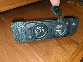

Do you/would you use any radio/USB/Bluetooth stuff in this car?
These are slide-in like a modern one, the top one has some resemblance to an old radio, the bottom one has some tiny built-in speakers. (it probably doesn't have impressive sound, but better than nothign?)
Other true 2-shaft radios (retrofits with modern electronics) look to be $200+.
There are versions of this with and without the cigarette lighter.
If this sparks any ideas with you, I might be able to CNC some type of filler plate that could retrofit some type of doo-dad in there for you for a reasonable price, to save you the grief of parts swapping and to install something useful in the hole.
Here's one I made an ABS plate for, to use some side-brackets with it.
I can make similar things from aluminum.
It’s not the entire firewall, it’s the hole where the air passes through the firewall. Need to remove the heater box and you will see welded in frame and a flapper door with a rubber seal. This area is different between air and non air.
Gary Goers sold the seals and listed different in the catalog, see photo.
549A or 549B
