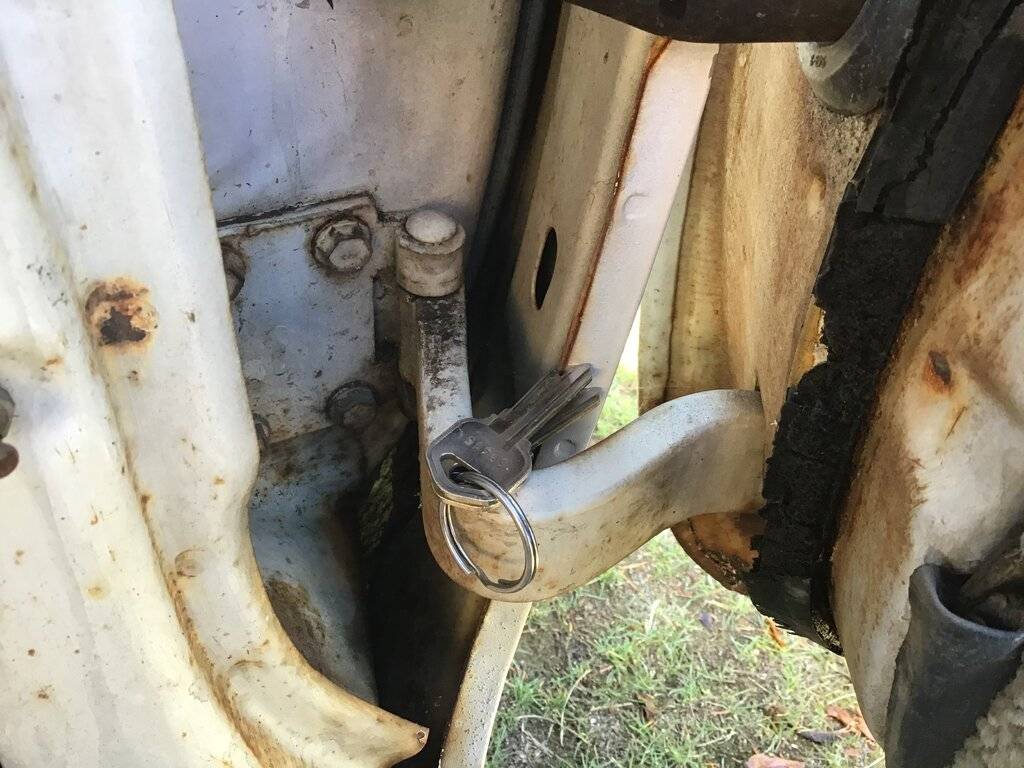

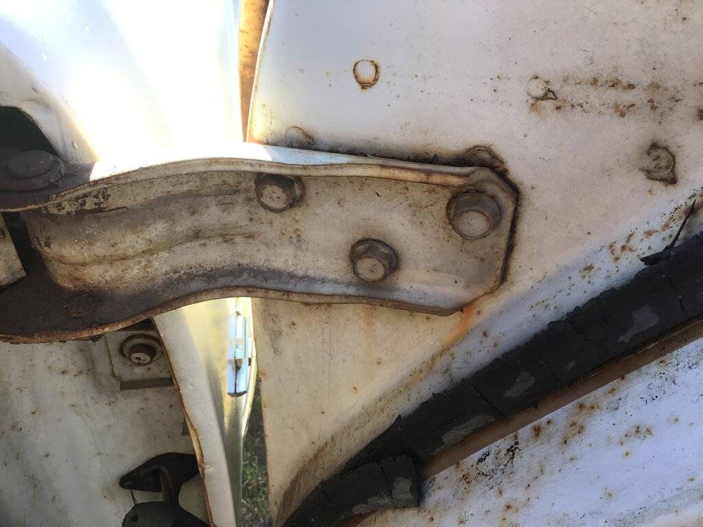

Ross, 1962 doors and hinges are “different“ than 65 and newer. Good luck drilling a hole through them, you’ll be there a while! LOL. That bolt head takes 9/16” socket, I put some keys on top for a gauge of just how think that hinge arm is.
The top hinge is no slouch either. And the plate the bolts thread into in massive. I just put masking tape along side where it overlaps the door, much easier.
odd thing is the door itself is not very heavy as far as doors go.

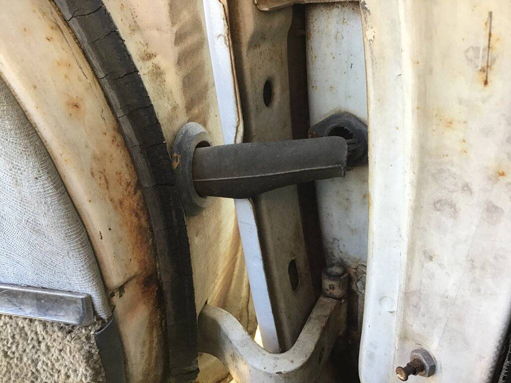

Last one is the wiring routing.
