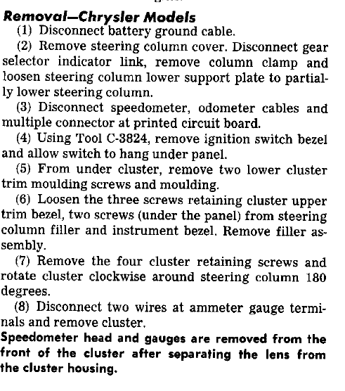

Here is the procedure for removing a 1966 instrument cluster, which is VERY similar to a 1965:

The first time I removed one I didn't lower the column, and rotated the cluster around it as described. Quite a pain, it gets caught-up on all the wires etc. back there. You need 3 hands, and there's barely enough room for 2 hands. I suppose if you plan ahead you could wire everything up out of the way. I was also worried about scratching the plastic face on the cluster, or dropping it. Things to watch for if you drop the column are to not scratch the paint on the shifter arm collar and don't yank the column around too vigorously because it puts a load on the rubber steering coupler, which is difficult and expensive to find a replacement if it tears.
