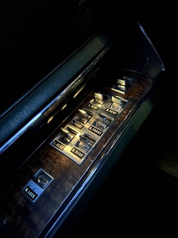

Hello @Devinism
About 2 years ago now I had you rebuild a rear power window switch for my 1972 Imperial sedan and it came back looking better than brand new and worked fine again.
I currently am restoring one of my 1970 Chrysler 300s and have the instrument panel out and on a bench to work on it to get everything functioning as new again and update it with some new parts. I too would like my dimmer switch rebuilt by you since you do great work and would just like a reminder of the address to send it to and your charge for the work. Feel free to post your response here or just send me a PM with your response. Thank you very much.

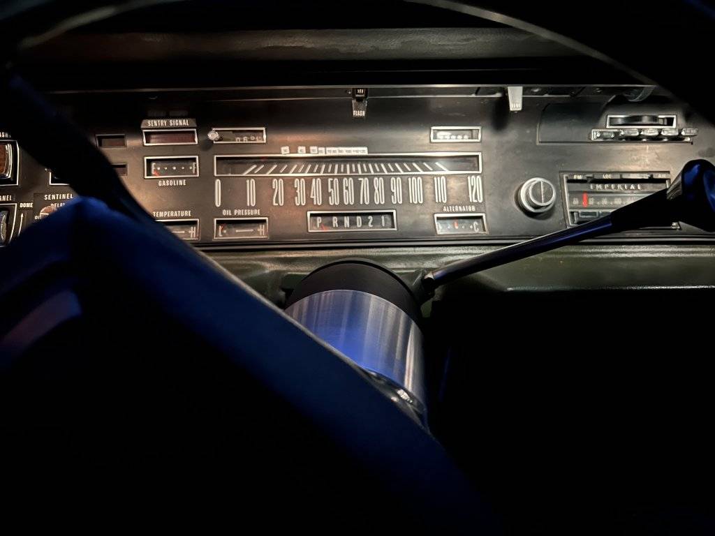

Hetes the panel
Hell of a cool looking instrument panel, but I'm MORE COMMITTED TO SLAB SIDED MODELS THAN EVER!
