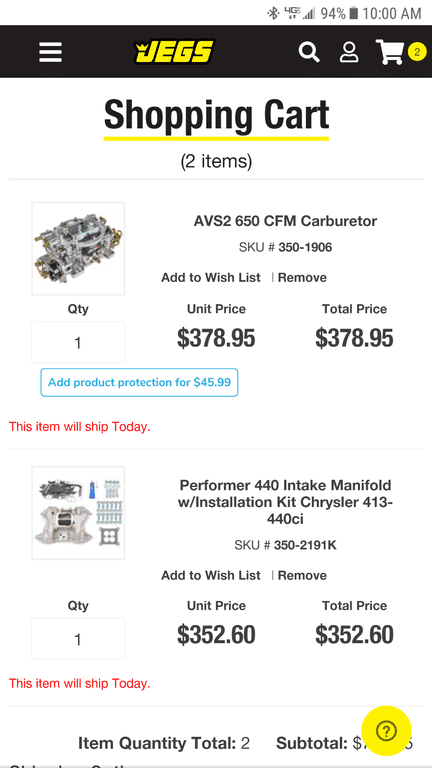

I have a 1965 Chrysler new yorker with the 413 and am looking to put an edelbrock performer intake manifold and edelbrock avs 2 650 cfm carb on. I was wondering if the a/c compressor support brackets will bolt up to the new manifold? Also anyone done this swap and know of any other issues to look out for? Thanks
