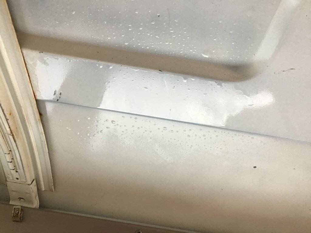

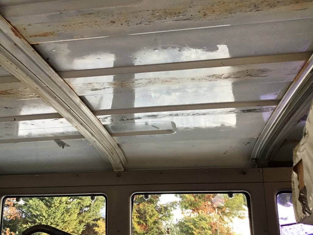

Ok we were dealt 3” of snow last night. I have a van with no interior. Here is what the I see of the roof looks like at 3pm. Just cleaned off the snow now. It was 28 overnight, got sunny at 11AM and is mid 30’s now.
Check out the water droplets inside on the ceiling of this van. The white paint is flat, so any shine is water. I have windows cracked open and there was a slight breeze all day.
