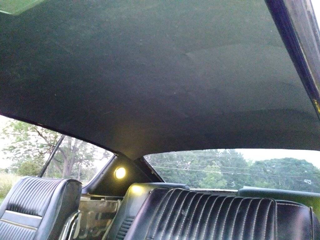

it took me a good part of the weekend to do the entire floor the way I did.

I used chassis saver after sandblasting the floors with coal slag. Then I used am epoxy primer over that to seal it all off before doing the sound panels.@swisherred, the carpet and seats look great! Love the buckets! We’re going to replace the carpet in our ‘68 New Yorker at some point. What did you use to paint the floor surfaces, and what did you have to do to prep the surface before painting?
