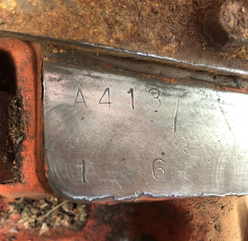

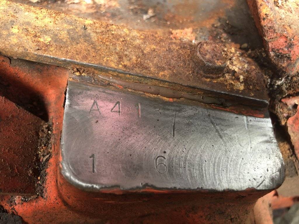

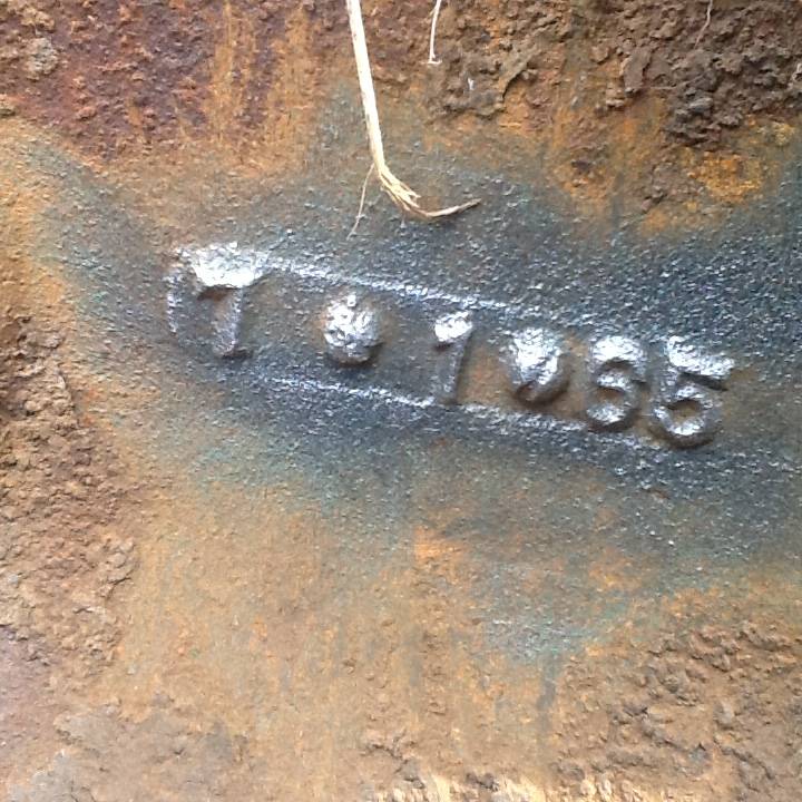

There will be identifying numbers and letters stamped into the flat pad just to the right and up of the thermostat housing - it will identify the displacement and the assembly date, and things like assembly differences (undersized bearing stuff etc.)

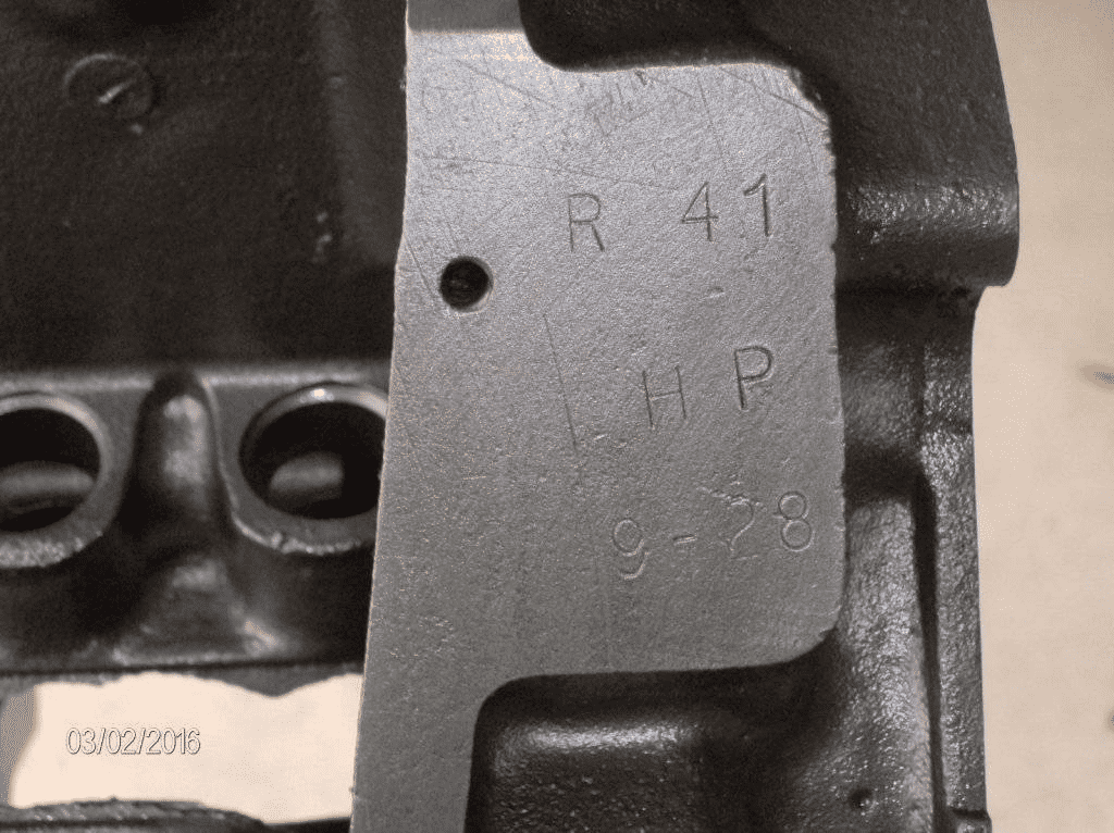

If you clean that off with a scotch-brite pad or such, and take a picture, we can confirm what you have there. Here is a pic of a 1961 413 engine's stamping pad -
R stands for 1961 MODEL YEAR USE (so S would stand for 62, T for 63), 41 stands for 413 (I believe), HP stands for the level of performance (I think), and 9 - 28 is the assembly date.

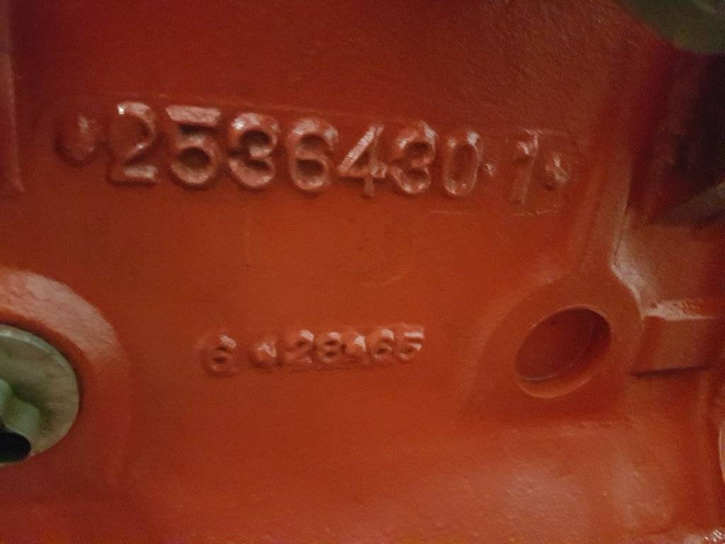

The assembly date should come AFTER the casting date, which is typically found on the side of the block under the casting part number such as these. Note that the examples of casting dates are not related to the first pic - these are for motors assembled in 65 for use in 1966 cars. So your 63 413 should have a casting date of mid 1962 up to early 1963.
Umm... Anyone noticing the dual point tach drive distributor?
I'm wondering what that engine is out of.....

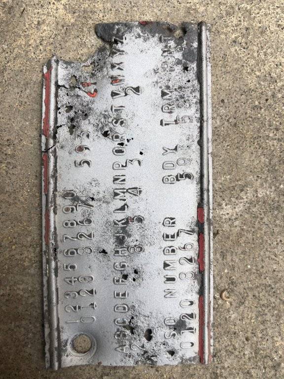

Here’s the money shot for what the car was originally.
And super decoders out there care to break it down while I take the valley pan strap off and search for more numbers?
As I read it I’m seeing: 123456789
With 0120 under 1234, 593 under a blank part on top followed by 21 after about six spaces, abcbefghij-etc.. number 2 is under A. 8 under H, 5 under K, 4 under M, 3 under P, 2under V. Last line, DSO Number is 0120, two spaces and 8267, Body is 593, trim is 584, paint is 99
Sequence code means Jan 20 of 63 build date (not necessarily the actual build date). A mid-model year build...

Were you able to find the casting date under the block casting part number?
Sounds like it's a transplant/replacement 413 anyhow, perhaps as you say out of a severe service vehicle like a police car. If that's so, nice! @Big_John - sharp eye on the tach drive dizzy. That says something right there!
I guess you need to see if the trans is so equipped with the good internals, and will bolt into your car without any troubles.

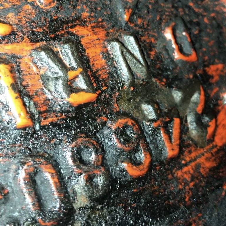

463039-2
DNR L
That’s what I got after I took the short video of the casting numbers I could reach
If that number is what you got of the side of the block, it should have a 2 in front of it - the 2 after it typically refers to the shift.
I think that you may not have got those numbers right regardless - any 413 or 426 wedge I have heard of has the number 2468 030 cast in it... but I could be misinformed.
Could the block casting part number be 2468030-2 ?
