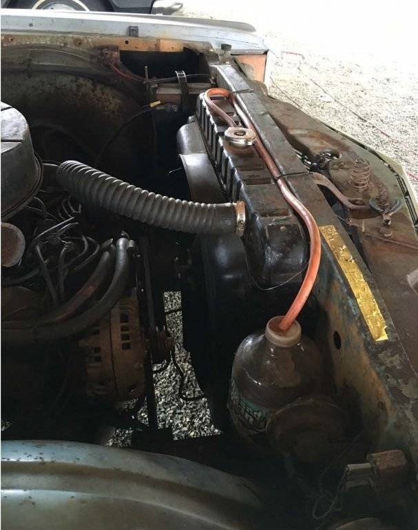

You say Al core, so it's not a copper/brass but aluminum with plastic tanks? The copper/brass can be taken apart the aluminum cannot because you can't get the gaskets to reseal the tanks to the cores.
Well dang. Not sure. They are definitely brass tanks, but look like aluminum cores. I'll have to take a closer look at the cores.
If they are brass tanks the core has to be copper, they are soldered together.
