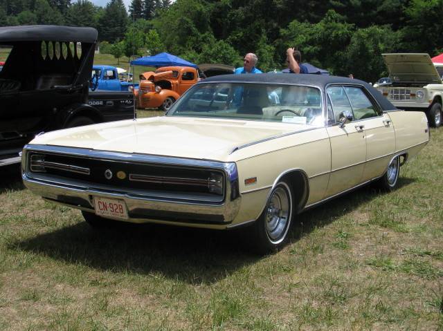

Welcome to the forum, pictures of your car are mandatory! Sorry, not great with brakes myself, so hopefully an expert will chime in soon.
Thanks, Samplingman. Below is the only halfway-good photo I have of the car; it was taken at a car show last May. Antique Ivory (yellow) body, black vinyl top, gold fabric-and vinyl bench seat interior, slotted road wheels --- just as it came from the factory.

Hi, nice car.

Welcome to the site from the Motor City! Very nice Chrysler.
