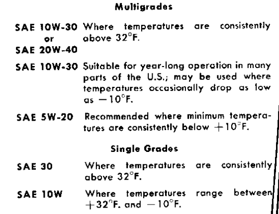

Our engines were designed with 10W-30 in mind. Here's Chrysler's instructions from the 1966 FSM, C-2 "Lubrication" p1, Col 1:

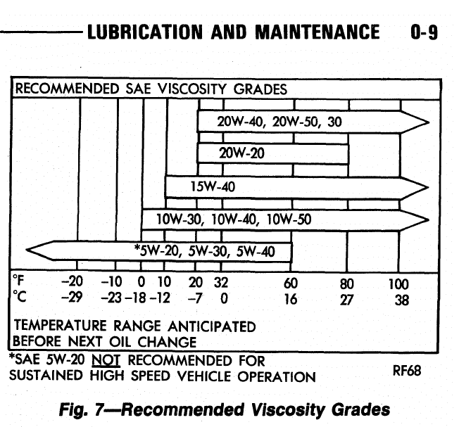

This remained fairly standard for Mopar engines for some time. As late as 1983, 10W-30 still was the factory oil. Here's a chart for my 83 Dodge D150, w a 225 /6:
The new 4 cylinder engines most often warranted the high viscosity stuff by then. Note how 5W oils were strictly for cold weather. I'll stick w 10W-30 w a bit of ZDDP for this old engine. After 6 years of VERY harsh abuse w me driving it in city traffic, summer and winter, the original cam, aged 54 years last October, was still sound.
I for one don't really anticipate ever driving my car when it's at the uncivilized temperature of 32f or below. The "20W20" oil type is - interesting. How is that not just a straight 20? And note that that chart does anticipate the existence of a 20W50 (was that type around years ago?). A 20W40 would seem to be ideal even for most of us in the northern latitudes. ?
Why would a 5W30 or 5W40 have an upper cut-off at 60F but a 10W anything is good to 100?
