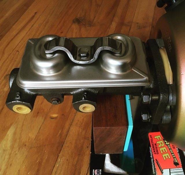

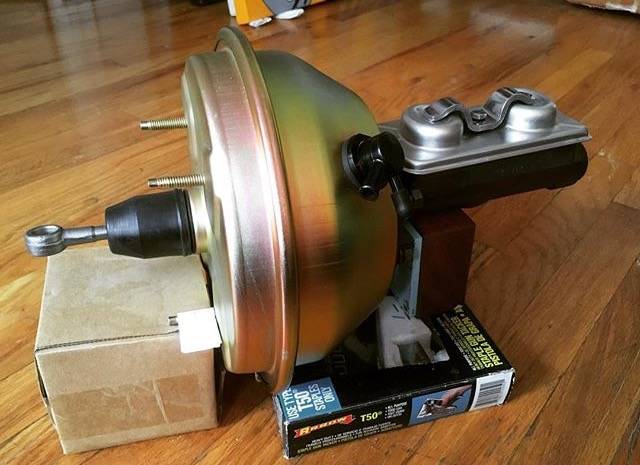

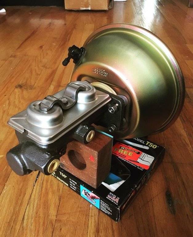

A lot of work went into restoring this original assembly for GG, my 1967 Plymouth Fury VIP. A big thanks to master machinist Brad at Brake & Equipment Warehouse in Minneapolis. He did beautiful work boring and sleeving the cylinder in stainless, as well as media blasting and powder coating it to a stock finish, all for $120. The lid was later replated with a factory correct zinc by Brake Booster Dewey, who completely rebuilt and plated my brake booster. These guys are both very easy to deal with, call you back, and stand behind their work. Great guys and very reasonable. I rebuilt the innards of the master myself (once Brad sent it back) with Chrysler NOS OEM pistons, brass seats, check valves, springs and lid gasket. I installed these in the car about 1-1/2 ago and haven't had any issues, although I do need to drive the car a lot more!
View attachment 178979 View attachment 178980 View attachment 178978
GG that’s a thing of beauty and you really ought to drive that car more often...:poke:
Wow, I usually marvel at the beauty of nicely finished engines, but your brake assembly takes the cake! don't recall this style of Master cylinder cover. My 1965 Fury has a single well master cylinder. So black was the original factory color?
