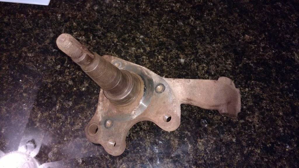

Picked up my spindles for my disc brake conversion this summer. Just getting ready to start the process and clean up the spindles. The one side looks great but this side is scored up pretty good and that dark spot near the base is a small hole.
Is this spindle OK, if so what should I do to it?
boat anchor for a pond boat...
and that sucks. You probably couldnt see it under the grease
That is what I figured dammit, I will see if I can get a replacement
Murrays a great guy he has a replacement for me. He didn't look at it real close and neither did I, and all the damage was on the bottom of the spindle.
I didn't bother examining it, because it was from Murray. He had just pulled them that morning before I got there. He said when he ships them he will degrease them and have a good look at them.

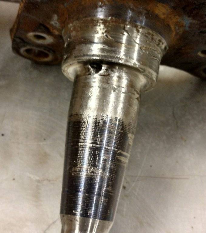

Could that hole be from somebody installing a zerk fitting to try to grease the wheel bearings?
I think that hole is from a spindle repair. Probably the bearing failed and tore up the spindle. They welded it up and machined it. The hole is a void in the weld.
I wouldn't use it... Glad to see Murray standing behind his sale.

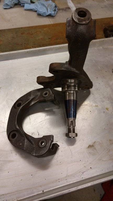

This is why we all refer to Murray when we need parts for our cars. Called him Saturday evening, holiday on Monday, I got home tonight and there on the step, my replacement spindle.
Now that is service.
