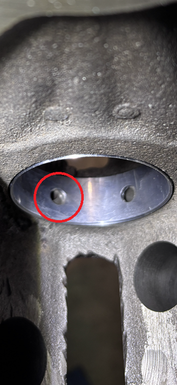

changing cam bearings in my 400 mopar. Got new ones in and this is my first time doing it. The one with multiple oil holes are very close, but it seems no matter what direction I try to change it will make the others worse other than a tiny amount. My question is, is this good enough based on the photos? Or does the lining up have to be 100% perfect? This is the 2nd bearing from the back I’m installing (the one with 3 holes).
Looks like the holes in the bearings are a big bigger than what is in the block? Which might be a built-in "safety factor" for installation?
Enjoy!

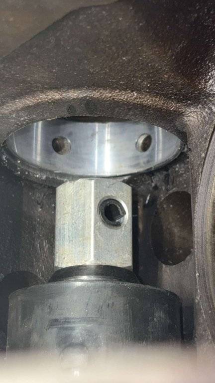

Engine builder pressed in the cam bearings, cam fits in very nicely, but he had problems with alignement of No. 4.

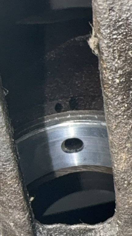

The passenger side cylinder head oil passage is half way blocked, wheras the other is sitting Perfect, as well as the lower Main feed Port.
Is this still good enough ?
I dont want to pull that bearing.

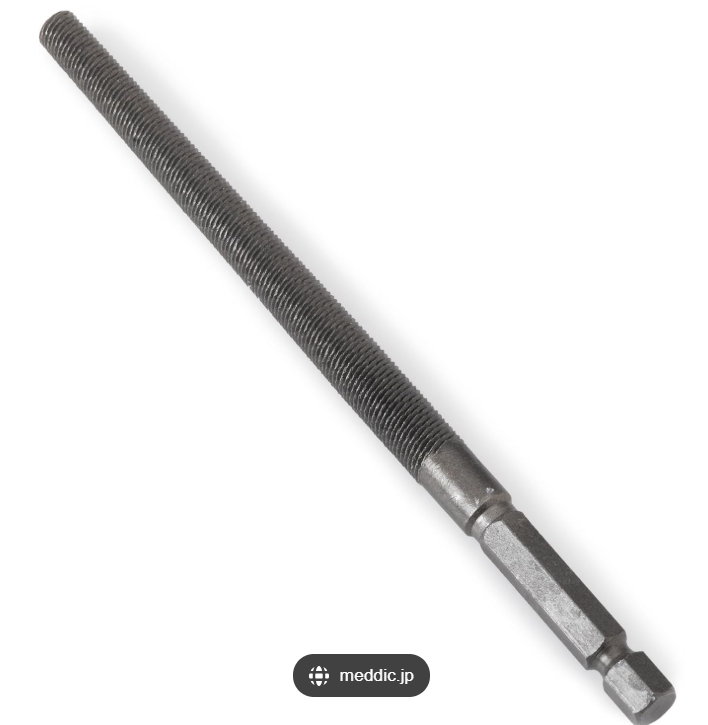

What is the best way to free up this passage if needed ?
Small round file ?
Long drill from cylinder head side ?
