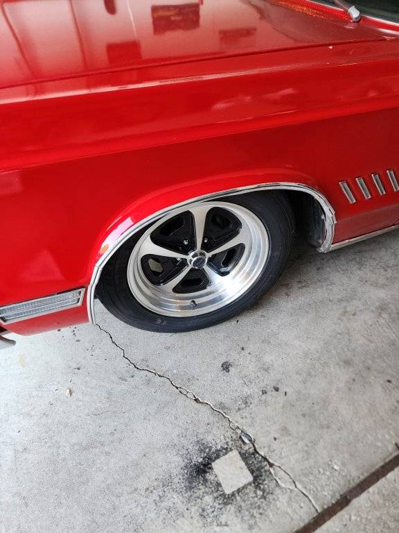

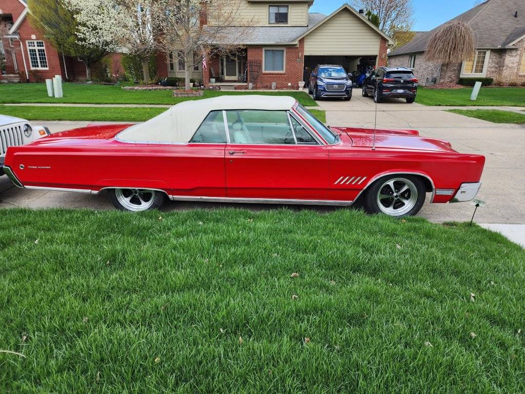

Any of you slabbies out there have Magnum 500s on your ride? Can you share some pics of the broadside of your ride?? If you happen to have 17 inchers on, that would be even better. If you could post your wheel and tire size it would be much appreciated.
I was reading some posts about old tires. Mine are in good condition, but well past 10 years now. If I am going to get new tires, I might as well get the wheels I have wanted for a long time. I have a ‘68 300 convertible.
Thanks in advance!
17" on my 68
