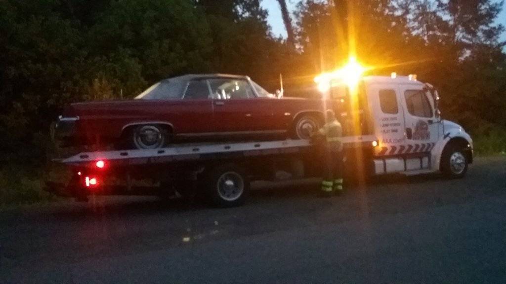

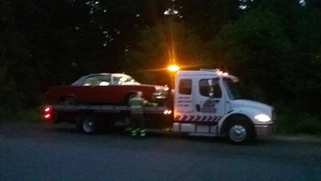

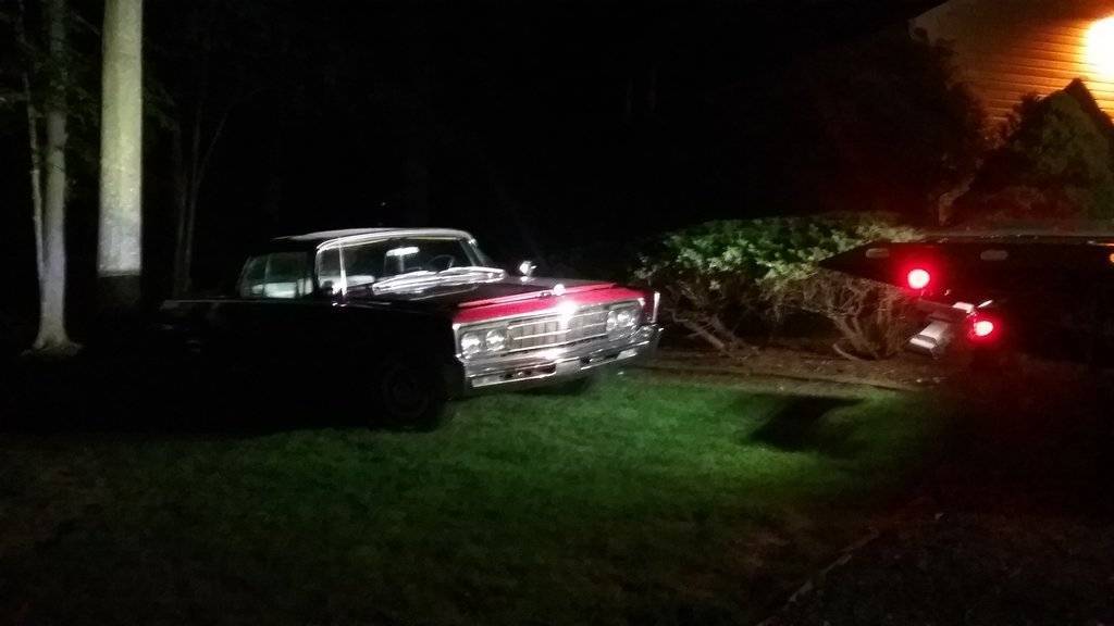

Anyhow - a couple more photos of the car being hauled the quarter mile or less from the side street to my yard Thursday night. Now it's time to move forward with the rebuilding process and get away from the bad juju of the delivery.
View attachment 140509 View attachment 140510 View attachment 140511

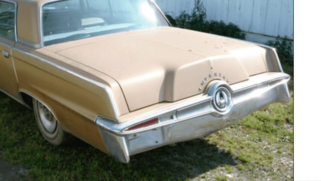

The trunk lid is different on the 66 then it is on 64-65. The hump on the trunk on the 64-65 is meant to look like a spare tire is directly underneath. On the 66, the hump is more squared off.
Most 1964 - 1966 parts are 99% the same, concerning body parts. The four-door, coupe, and convertible rear body parts swap straight-up between cars and years.
BUT - the '66 deck lid does not have either the bustle or the lettering of the '64 and '65 cars.
The '66 lower rear bumper is unique in that the reverse lights are mounted there, and not with the taillights. The upper portion (what I call the "propeller", because it looks like one!) is the same all three years.
The chrome extensions that bolt to the body (behind the bumper ends) are the same for all three years.
The aluminum garnish moldings on the bumper interchange, but I believe '66 has a different pattern than the earlier cars.
The outer lenses are the same all three years, as is the trunk latch and locking mechanism.
The chrome extension moldings are different for '66 .the "64 & "65 are same.It's Because of Different molding peaks on fender tops.
The Aluminum garnish pieces were the same for '64 and '66. For 1965 they were cast & chrome plated.
Trunk key cylinder assy.Is same for '64 and '65. The '66 had a New modern Lock assy.The Latch and striker were same all 3 years,as stated.
