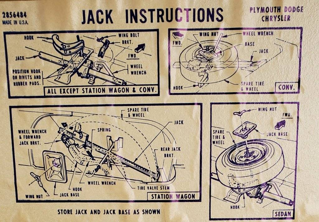

Also, is it the base of the jack that goes into the top of the spare with the threaded rod through it to secure the spare?
I suspect the basic jack and base will be the same as other C-body cars and possibly some others, BUT the difference could well be the piece which interfaces with the bumpers, which snaps into the springed-recepticle on the moveable section of the jack. I suspect the lug wrench might be more universal, too? BUT always check the lug wrench to ensure it fits the lug nuts on the vehicle!

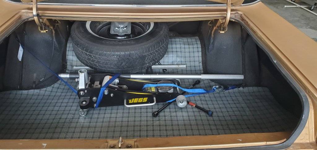

As I recall, the jack base, turned upside down, goes on top of the spare tire, the retention stud sticks though it, and the wingnut screws down against it. With the jack "stem" laying under the tire.

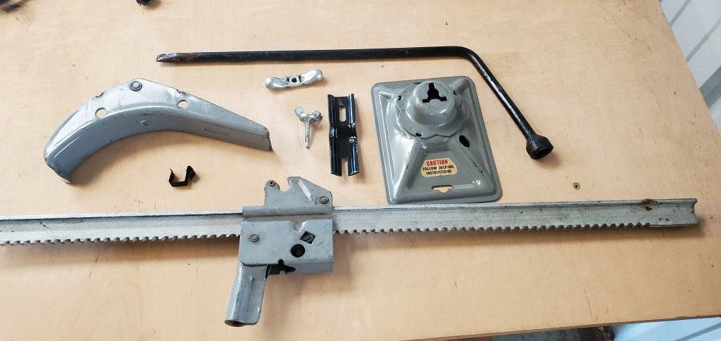

Yes. Many of them are the same jack. Yes the base inverts and yhe wing nut holds it all together. In my 69 300, the jack lays under tire with wrench
I can get a picture if you like. Go to a junk yard to find one and clean it up. People online want $200 for a $10 jack.
69 Chrysler 300.
The little black "U" clip is not for the jack. That mounts to the left side trunk arm/hinge and holds the vacuum line for a trunk release and wire for trunk light.
All three 69 Polaras that I have/had used this jack assembly (make that 4, a parts car as well, make that 6, my friends two 69 Polaras as well)
