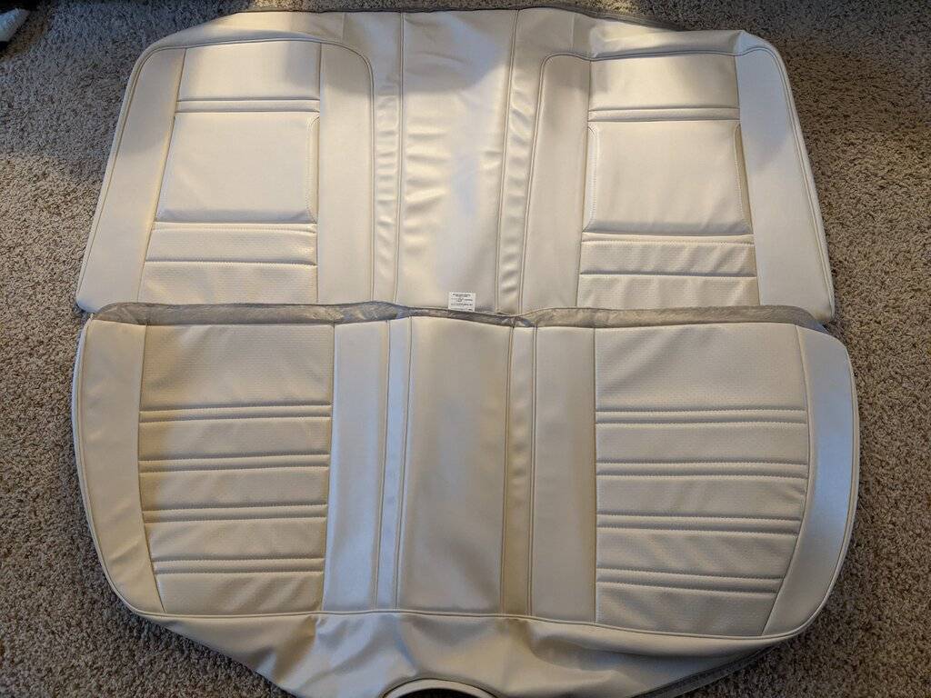

Got my Legendary interior today! Ordered back in October, they told me about 12 week delivery, close enough.

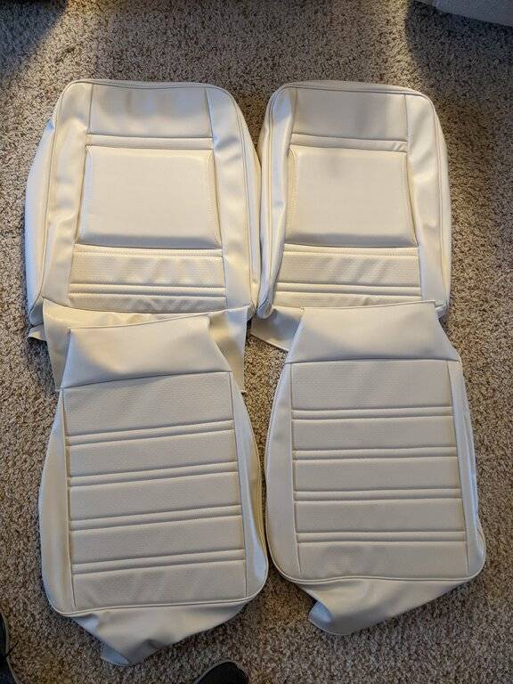

Updates! Got my seats back from the Trim shop. They look great!! Sorry about the lighting on the buckets. They are the same color.
As a side note, Foam inserts 1840-ST68 really don't fit. Trim shop was able to use the bottom pads, but added length and width. The back pads he didn't use. Made his own....so, just a FYI
UPDATE!!! Upon further review, and checking numbers that are molded into the foams, it seems as though I had "A" body seat foams. Right part number on box, wrong parts in box ... I gave them to my trim shop, they made them work, the bottoms anyway, So, I am retracting the statement that 1840-ST68 do not work. They may, I just don't know.....
