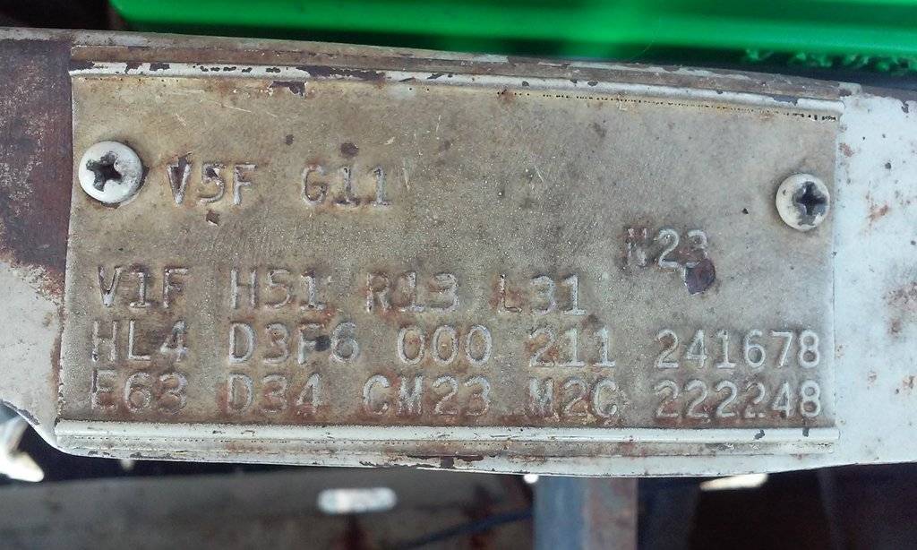

here is the fender tag for the 72 that is now on the road and running good after a intake leak and a carb

I remember reading your 2019 post re: moldings, but just stumbled upon your first thread re: CM23M2C222248 -- very nice HL4 Newport Custom! As @Ripinator said, nice period color. As @saforwardlook often says, yellow/green or beige/green (HL4 with D3F6 interior and V1F vinyl roof) combos work very well on these cars.
