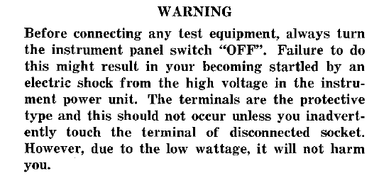

"If you try to repair your Astra dome, be cautious of the big capacitor as it bites"
The FSM says something like, "it won't kill you, but it can be very 'suprising'"
Didn't know about this good advice. I have a big resistor in my electronic tool box to discharge big fat capacitors. I have electrical tape on the leads closest to the resistor, so I can bend them, to discharge capacitors
From the FSM:
