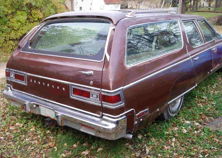

Here are a few pics of the T&C, the 440 runs great, just the lean burn was replaced with a standard Chrysler electronic ignition system. The bad part is the mech who did it tied the vac advance to intake manifold vacuum as the Lean burn TQ has no advance port so its a mutt off the line. Not sure if I should look for a computer or complete the conversion with a conventional TQ. My biggest concern is the left rear quarter panel....pretty soft around the fuel filler door and the lower portion of the quarter is full of filler...no matter as it will be fixed! Hopefully Phoenix Graphics still has the marine teak wood grain applique' as that definitely has to go back on! Almost forgot...I located this site in my search for C-body info etc. Looked like a good idea to join!

Welcome! I'm out in Lorette and have restored a 77 T&C myself. The quarters are often soft on these and nobody makes the correct woodgrain for a Chrysler (I had to paint on mine)...but don't let that stop you! If you need any advice, let me know.
Good luck with your restoration! My wagon is below.
