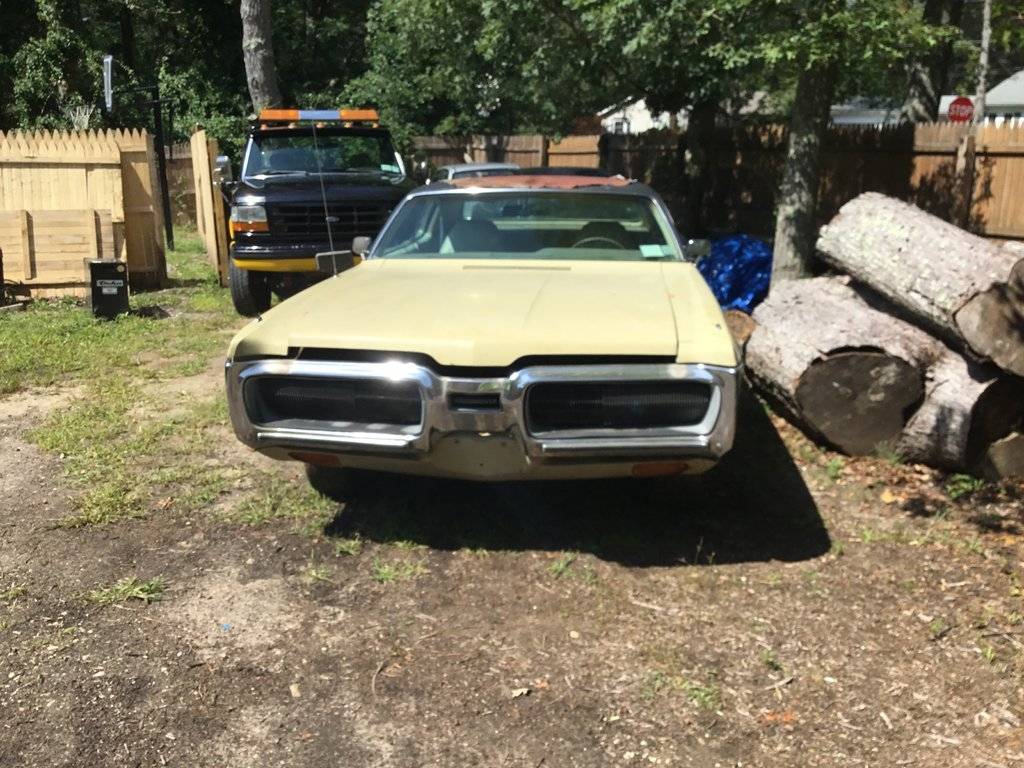

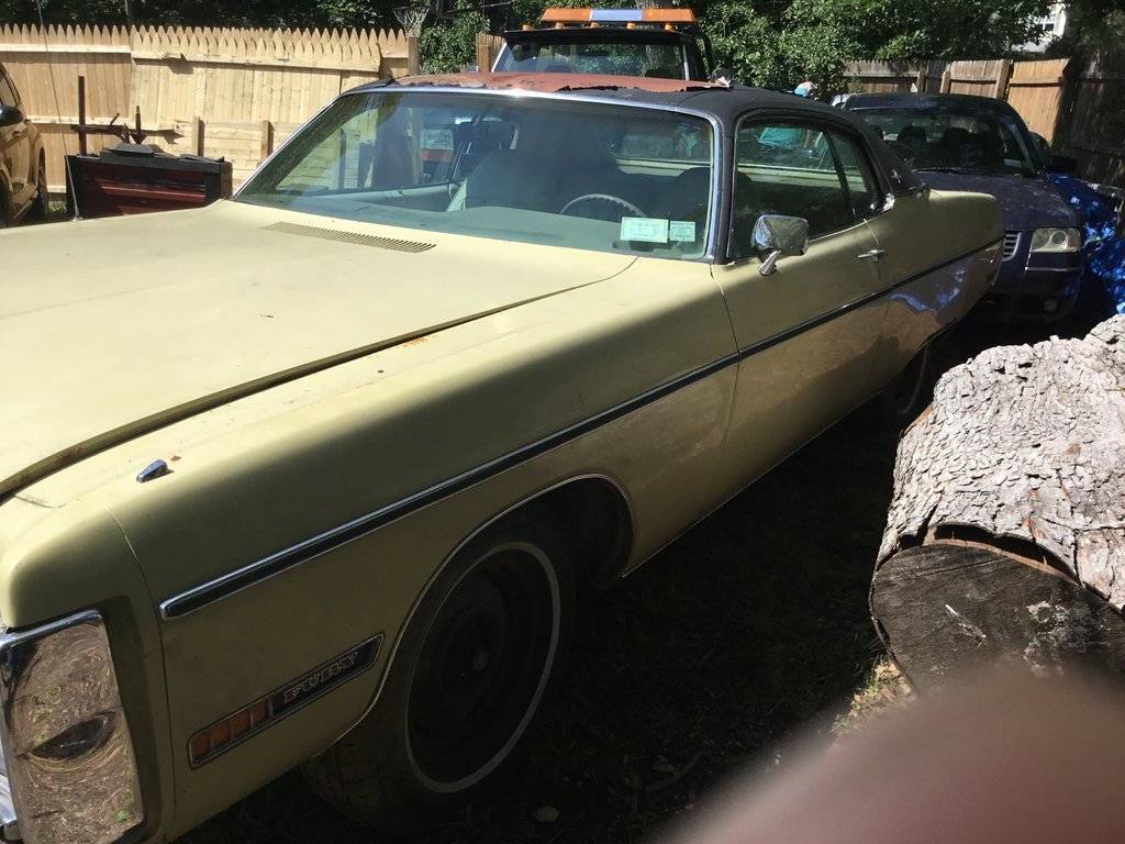

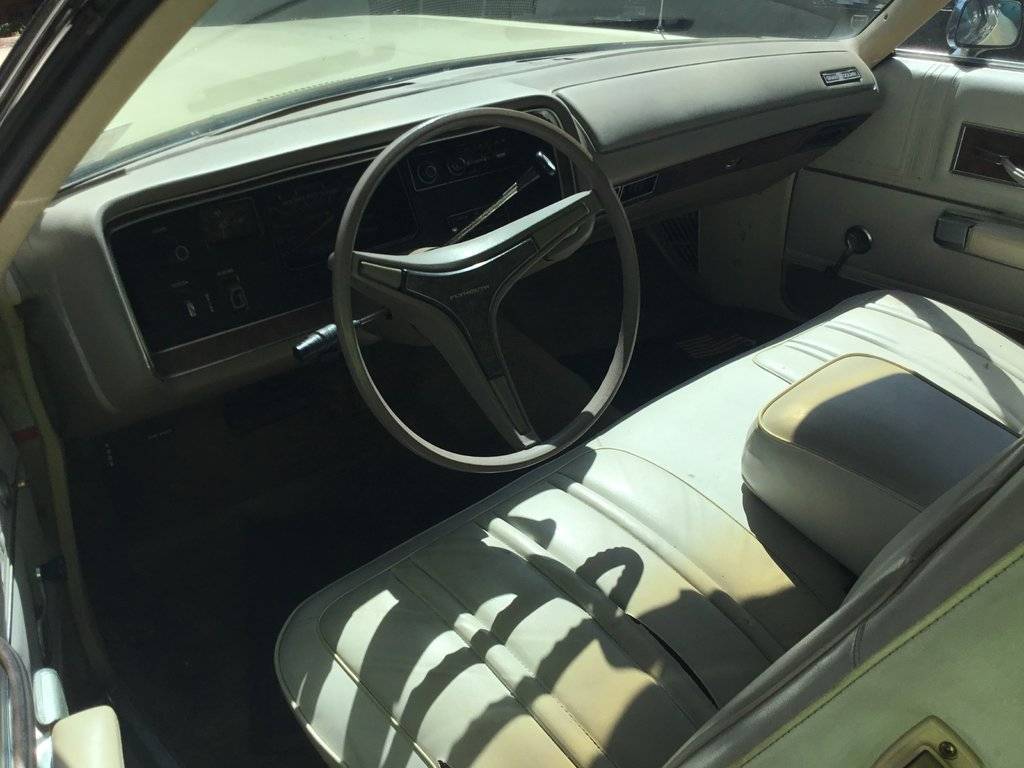

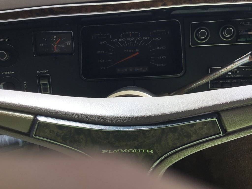

I just drove down to NYC area and bought a 72 fury gran coupe. Car has never been bondoed and retains its original paint, has some rust in the quarters and small holes in bottom of fender. 70k original miles, car spent the last 12 years in a parking garage in NYC.

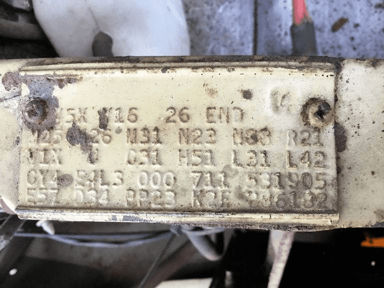

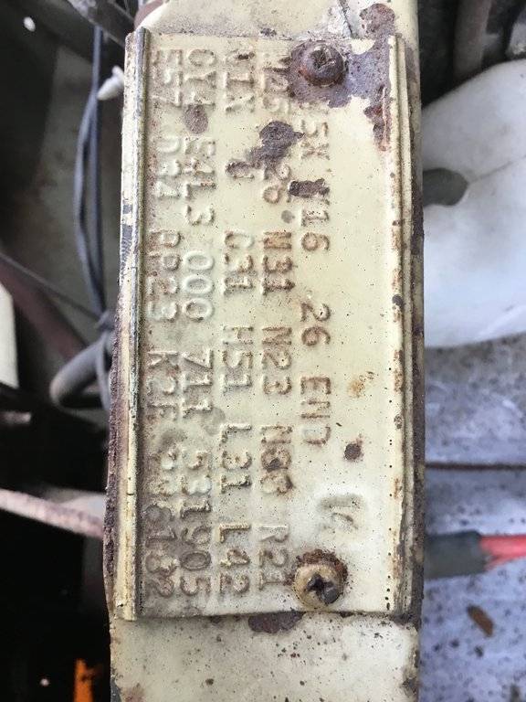

I DECODE IT FOR YOU
PP23:
Plymouth Fury
Premium
2 Door Hardtop
K2F: Unknown
1972
Newark, DE, USA
286182: Sequence number
E57: 360 cid 2 barrel V8 255hp
D34: Light Duty Automatic Transmission
CY4: Gold Exterior Color
E4L3: Trim - Unknown, Vinyl Split Bench Seat, Parchment
000: Full Door Panels
711: Build Date: July 11
531905: Order number
V1X: Full Vinyl Top, Black
U: USA Specifications
C31: 69 only Left & Right Head Restraints
H51: Air Conditioning with Heater
L31: Hood/Fender Mounted Turn Signals
L42: Headlamp Time Delay
M25: Wide sill moldings
M26: Wheel Lip Moldings
M31: Belt Moldings
N23: Electronic Ignition System
N88: Auto Speed Control
R21: AM/FM Radio (5 1/2 Watts)
V5X: Body Side Stripes, Black
Y16: Sales Bank
26: 26in Radiator
END: End of Sales Codes

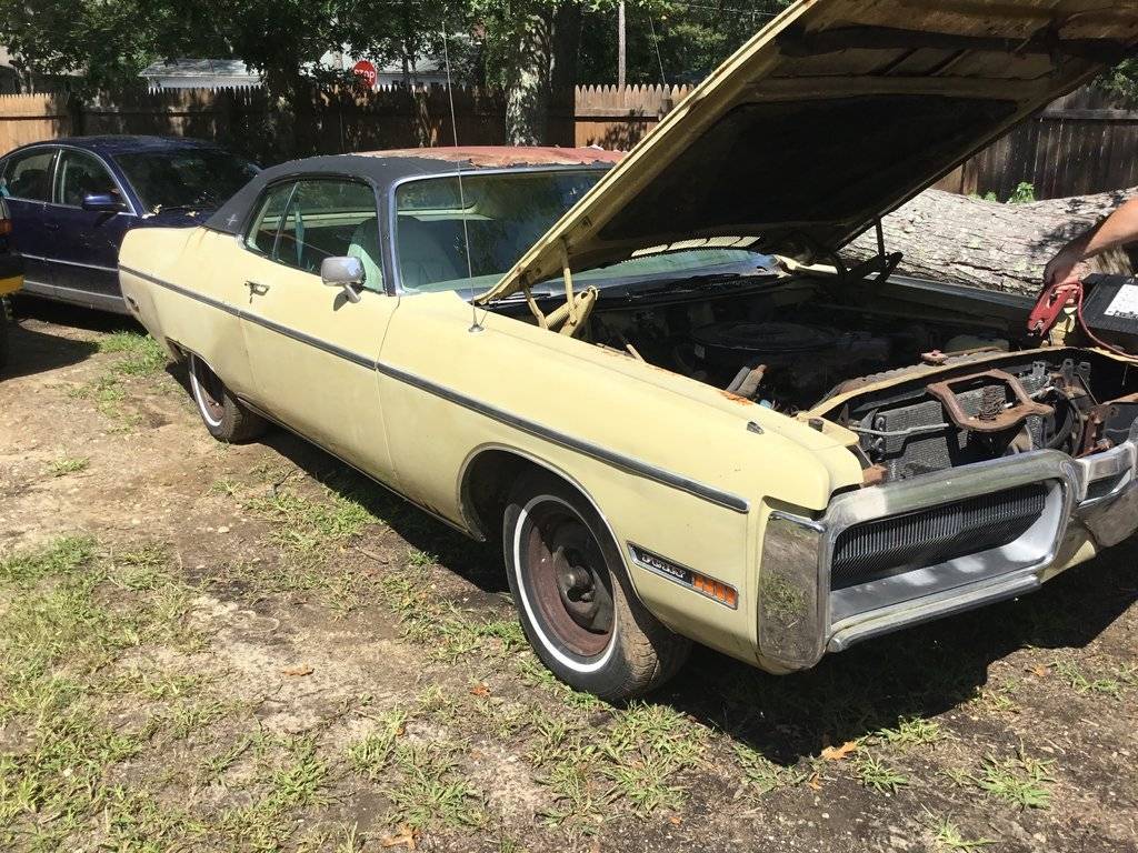

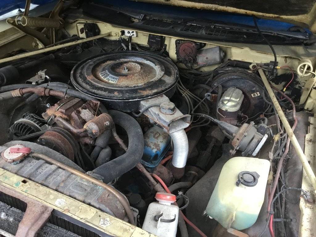

Transporters dropped the car off this afternoon from NY. Spent time looking over the car, floors frame and underneath are rock solid. Spent time cleaning the cobwebs out of the engine compartment, as car has not run since about 2004, prior to buying it we pored some gas down the carb throat and it fired right up for a quick second.

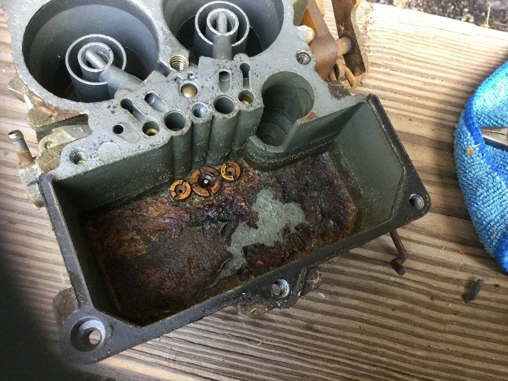

Was able to do some work to the car this weekend, trying to get it to start after sitting for many years. Took each plug out and squirted a little mystery oil in each cylinder, changed the oil, primed the oil pump. Ran an auxiliary gas can to the fuel pump, fuel pump is still good,amazingly. But the car still would not fire up unless you dump gas down the throat of the carburetor. Ended up taking the carburetor off and disassembled it for a rebuild, the carb was all caked up with crusty old gas **** inside the bowl (see pic of the crusty ****), now it is soaking in cleaner until clean and then will rebuild Carburetor.
