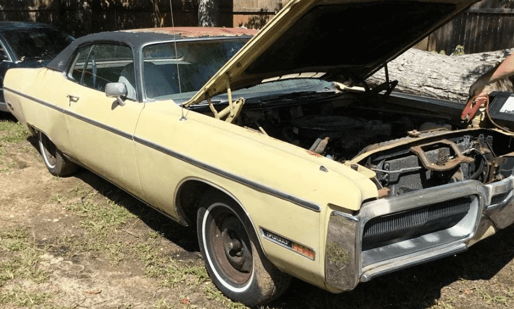

Just picked up a 1972 Plymouth Fury Gran Coupe
Getting there, most of the stuff is loosening up.
I haven't seen one that bad in a while, than again I don't see a whole lot of carb's anymore at work.

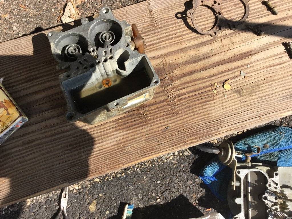

I finished rebuilding the carburetor, took off the line from the pump blew out the line with carb cleaner and compressed air, new fuel filter and rubber hoses, put in a new fuel pump and it fired right up running off a 5 gallon gas can for now until I clean or replace the tank.

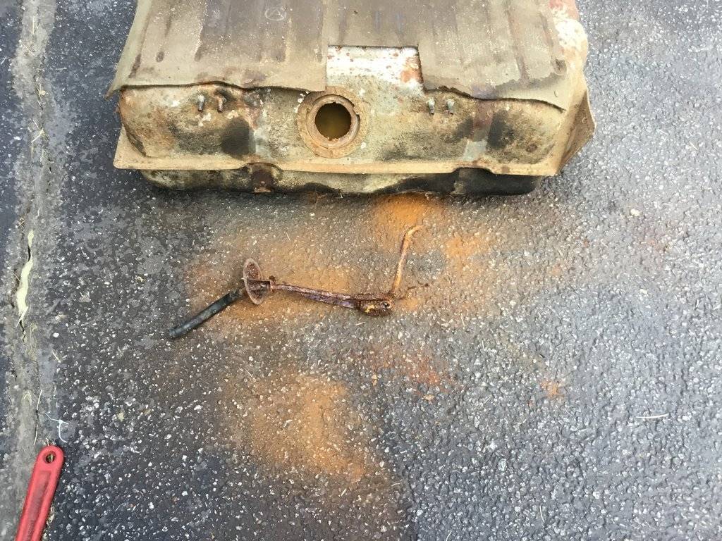

Got the tank out, it is totally shot, can push my fingers through the top, sending unit shot too.

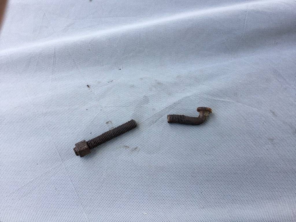

Tank I don't think has ever been out, as it still had the factory crimp fittings on it for the pickup line and vents. On the better note trunk floor is rock solid where the tank was. Does anyone still make the j hook things that the tank straps fasten to the body with (see pic)?
seems l have nos front lower sig clear lenses for a 72 if your ever lookin for a set
Afew plastic tanks snuggled in the trunk would be as safe as what you removed IMO.

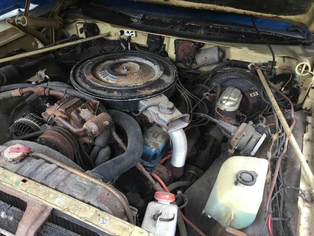

Super happy to see the car escape NYC! Great score! :thumbsup:
That's one really nice washer bottle! If this is your first Fusey, be real careful not to lean on it when you are working on the engine. Especially when changing spark plugs or adjusting the PS belt, or putting the battery in or out. I know this well from experience. :(
