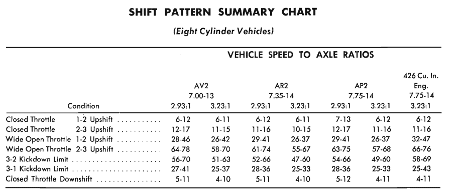

Your pics above look good I have had many the same as yours works above. As long as your shift points are where you want them you are golden. If it upshifts to soon adjust it out 2 turns, if it is shifting late adjust it in 2 turns then drive it. Repeat this until it shifts where you want.
I know you already have the FSM but here are the recommended shift points

Dan, set it to your FactoryShop Manual.
Then test drive it.
Under light throttle you shoyld feel it shift from first to second around 10/15 MPH and then into Drive by 20/25 MPH.
If the shifts are buttery soft adjust the linkage where it is closer to the carb linkage.
Under hard acceleration Drive should shift firm by 40 MPH
