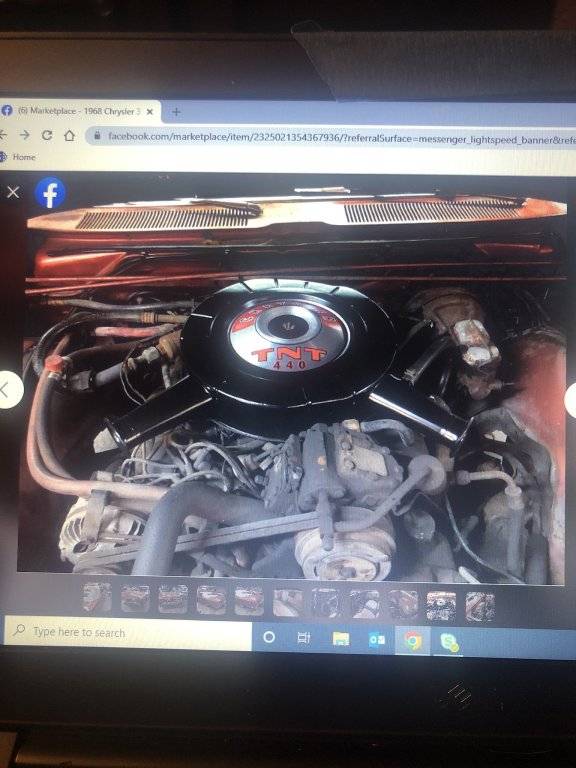

Hey all; doing the fuel system in my 68 300 convertible with the 375 Hp 440 is the sending unit the 3/8 or 5/16 ? hands
