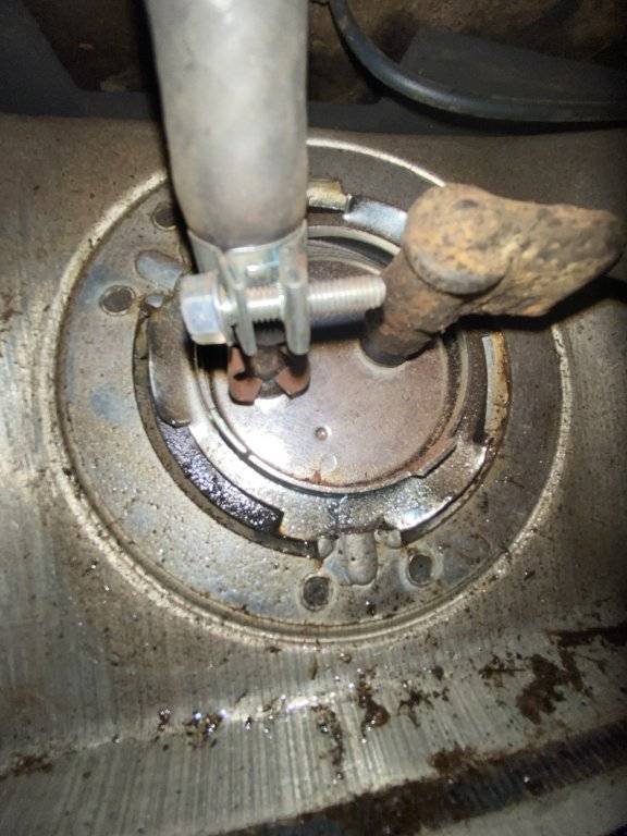

Hi everyone. Can someone tell me what I'm doing wrong? I bought a new fuel tank, sending unit (Van's) and lines (Inline Tube) for our '66 300. Before I strapped up the tank, I installed the sending unit, centering it into the notch on the tank, put the gasket over the unit and tightened the lock ring with the proper tool. Excited, I started filling the tank. At about 16 gallons, fuel started pouring out of the bottom of the sending unit. After siphoning gas back out, I loosened the ring, took out the gasket and visually checked the new parts as compared to the OEM and looked fine. I mistakenly ordered another gasket and lock ring (I didn't know that they were supplied with the new tank), so I decided to try the other set. Got everything back together and... well you know. So now I'm pissed since I want to move on from fuel and into brakes. Any suggestions?
Or if you don't have a factory lock ring you can try using two gaskets. That has worked for me.
Should the gasket/seal be between the sending unit and the tank? Or did I read that wrong?
Many others have noted the apparent non-robustness of the aftermarket lock rings, similarly noting to re-use the production Chrysler lock rings instead.
CBODY67
CBODY67
Bingo.
Detroit Muscle Technolgies has the correct thicker lock ring, it measured as thick as the original I have. The gasket goes between the tank and the sending unit as well but that was already pointed out.

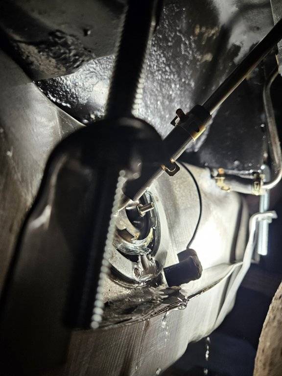

Mine leaked this past weekend on my maiden voyage. I hadn't put over 5 gallons in it at one time yet. On the way home from the show I put in 10 gallons and it poured out. It appears I may have put the rubber seal over the sending unit as well. Do we think that is the issue?
