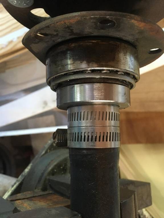

I posted this in the "tool tips" thread, but thought it would be good to post it here too. I used two hose clamps to protect the seal surface while I removed the old bearing.
Yes, knowing that the shafts didn't get gouged during disassembly is worth that money.
