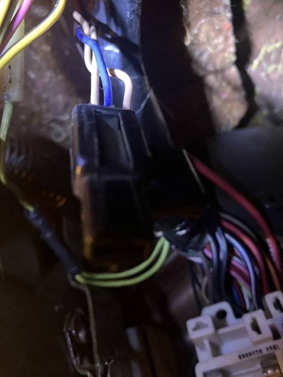

Thank you to Big _John for his last answer, and after taking this photo, my back will be giving me pain for three days.
What on earth is this connection for?
The connection is a black rubber piece, that doesn’t appear to have a corresponding male fitting anywhere nearby.
It’s under the dash, down near the brake light stop switch on my 72 Fury.

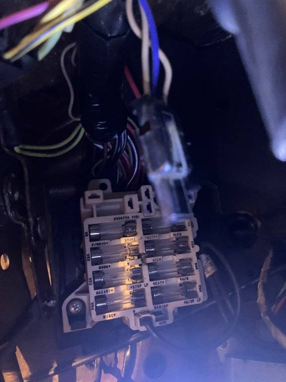

I will post both photos I took, because the 3 wires appear to have different coloured wires, depending on the angle and lighting..
I’m always grateful for the input that anybody has.
Chrysler was known to install the same harness in the line with or without certain options to keep costs down.
It may be for cruise control brake pedal cancel switch??
2 cars, one with cruise control and the other without got the same basic harness.
The car with cruise, its optional separate harness was added..just plug n play.
Ditto light group cars (map light, rear door jam switches in 4drs)
Radio delete cars still had plugs for a radio and sometimes even the dealer will install a radio or a rear defogger.
Very common to see bare bones cars have a harness with many extra plugs not in use.
Hope this helps.

I don't believe that is for the cruise control connection to the brake switch, but I could be wrong.
