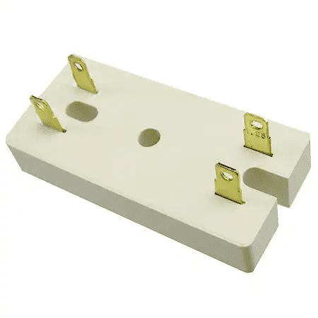

413: changed the ballast resistor and the car started this morning (old resister I kept in glovebox looks thicker than the one I got from Advanced Auto). Keeping my fingers crossed that it keeps starting.

I replaced the original distributor with an MSD distributor and the mechanic was able to eliminate the electronic control module.
Umm... No ballast resistor with the MSD distributor.
Check the manual if you don't believe me.... I seem to remember you having a "mechanic" install that... Obviously he didn't follow the directions, so who knows if it's wired correctly or not. That leads me to think that the ballast resistor is the cause of your hard starting issue... NOT because it's bad, just because it's there.
Any chance your resistor looks like this?
If so, and the MSD junk (yes, I said junk) is wired with that, that will limit current while starting and while running...
Either way, even if you have the BR with just 2 connections rather than the 4 connection shown, the car NEEDS to be wired correctly to RUN correctly.
