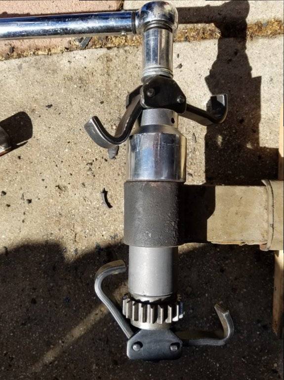

Once I removed the fronts, I pressed them in with an internal spring compressor, timing chain gear and a large socket. Easiest press-in bushing install ever.
