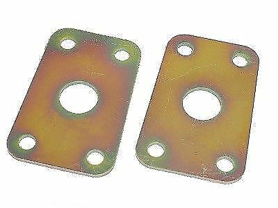

These are advertised as 1962-72 Mopar B, 65-73 C Body Leaf Spring Reinforcement Plates. Where exactly are they mounted?
So they're just flat plates? Something you can make yourself?
And why are rear shackle costs so high? A couple of bolts, the bushings, and 4 plates you can also make yourself?
What exactly is their purpose? I haven't heard of anyone ripping the front spring hangers out? Not being sarcastic, actually curious because I'm getting ready to replace the bushings on my leafs as well as having a 500+ cube stroker built for my fury so any legit stuff that can be reinforced that would actually be an issue is good to know.
If they go where the front of the spring attach to the rear frame rails, are they a rust repair item? Why the hole in the middle, then?
On initially looking at them, with that big hole in the middle, to me, that would be where the end of the center register bolt would be, with the outer holes being where the u-bolts go through.
