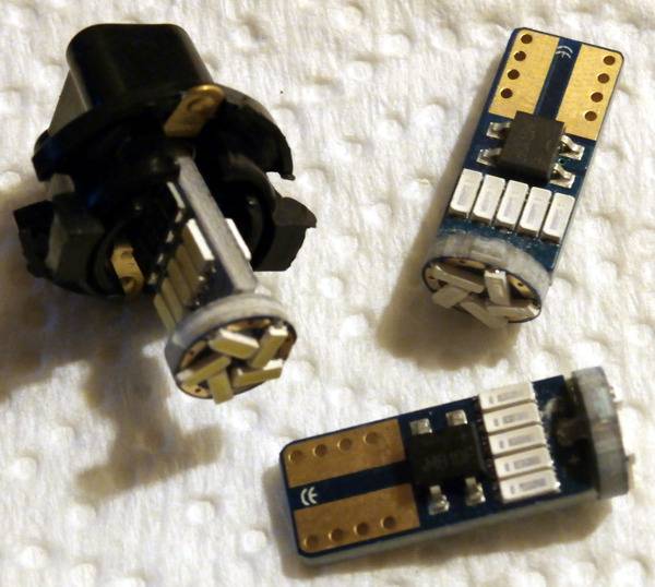

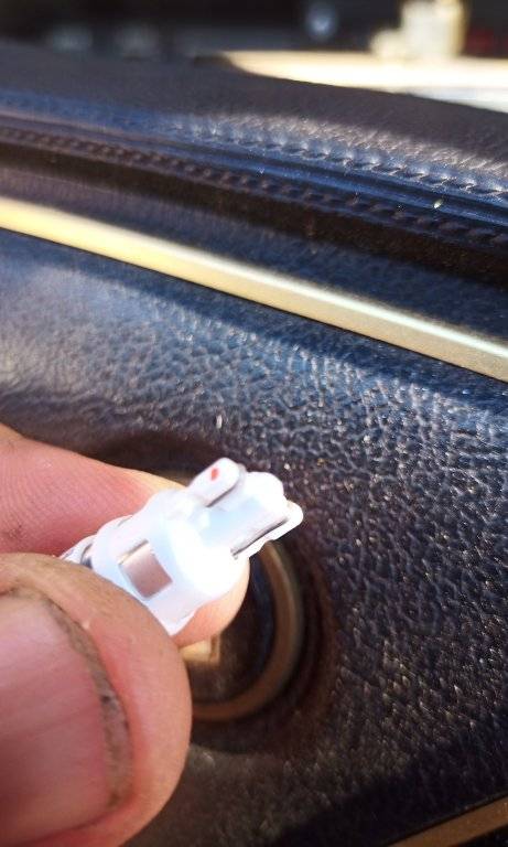

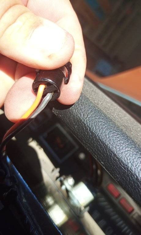

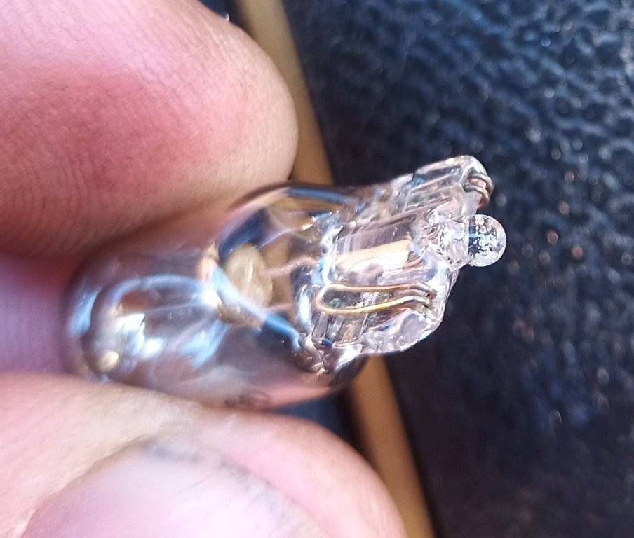

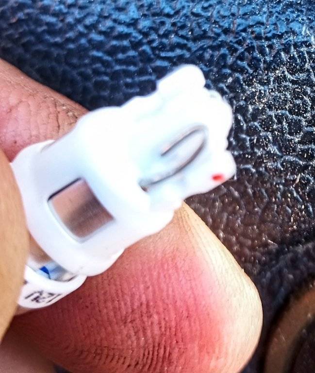

Anyways I picked up a set of the Sylvania blue lights at AutoZone. Wasted a whole bunch of time troubleshooting a blown fuse until the issue dawned on me. The OEM glass bulbs have contacts that fold in either direction against the glass envelope. For God knows what reason, the LED lights have contacts that wrap all the way around the bulb base. I can only assume there are models of the vehicles where the female end of the connector only has power on one side of the terminal, but that isn't the case on this design. ( I wish there were way too integrate photos into the text, so I'll just call this fig. 1)
Of course once you know there's power on both sides, you realize that inserting the bulb with contacts on both sides is essentially a dead short, blowing fuse immediately. Once you know the cause, the fix is simple enough.. simply Bend The Wire to contact only one side of the base, as on the OEM bulbs.

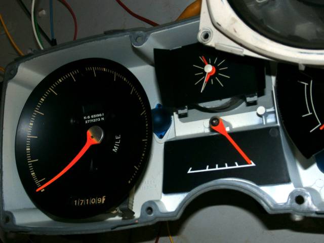

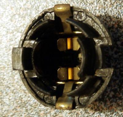

I happened to have a spare 1967 Monaco instrument cluster handy, I pulled out one of the bulb sockets - here it is:
The contacts are on the ends, not across the sides like yours. Strange.

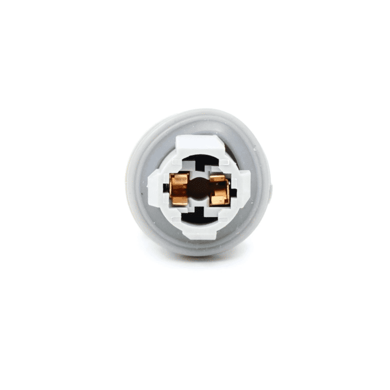

These are known as Twist Lock Wedge bulb base for T10 / 501 / 168 / 194 bulbs.
And all the ones I see on-line have the contacts arranged side to side (ie left and right, not on the same side).

But still everyone is missing the point - why are @Carmine 's bulb sockets strange? They don't seem to be correct.

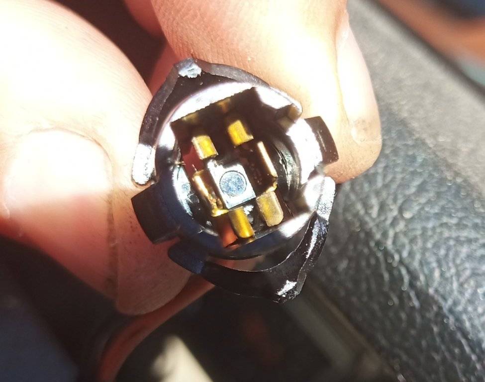

Since you're getting the point, I'll include a bonus photo...
At the same time, this is one of the most unmolested cars I've ever owned. 69k miles when I bought it, original paint/top/seats. Not a single screw seemed out of place when I dropped the IP lenses. Factory wiring still in place.
I could picture connector designs where these Sylvania bulbs would never have an issue. And I could imagine bulbs where my (bad design) connector would work for 56 years, lol. But my connector + these bulbs? Zzzztt!

I think the big difference is that most of the dash lights just "screw" into the holes on a circuit board and get power from the face of the board.
What's different with yours is the socket is actually wired with both a negative and positive wire. That tells me it's most likely in an area that's not grounded. I don't know as I would call it a bad design, it's just a different design.

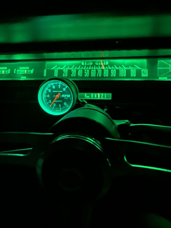

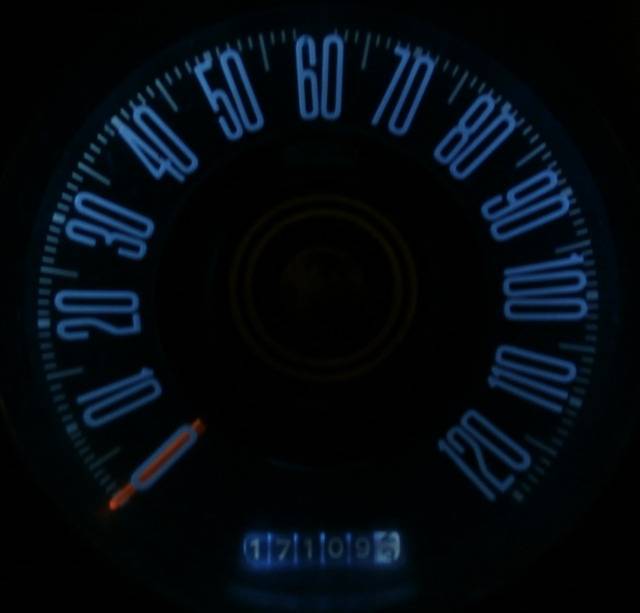

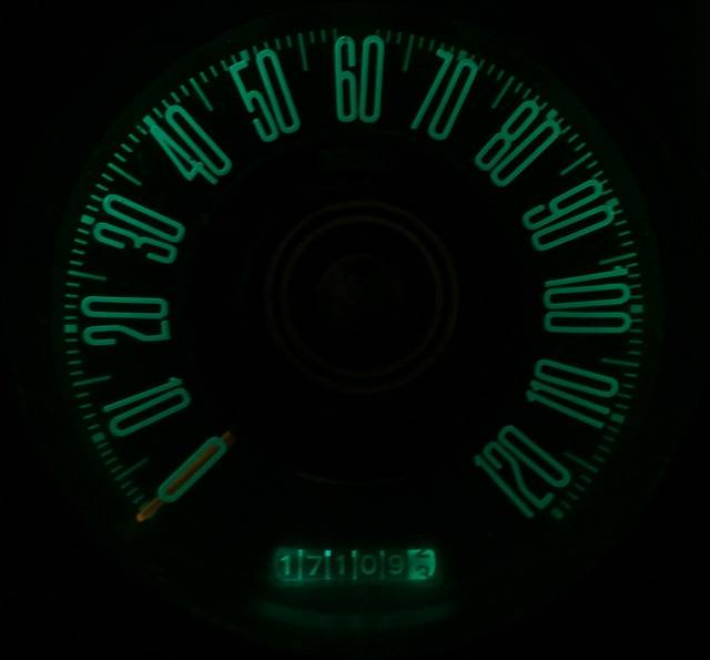

Here's an inside look at the dark blue filter that surrounds the backlight in the '67 Monaco / Polara cluster:
As dark as that is, I guess there is a blue hue to the light, to me it's not that much. Here's what the speedo looks like with a white LED bulb (the type shown above in post 5)
And here's how that looks with a green LED (this is a green LED shining through the blue filter):
