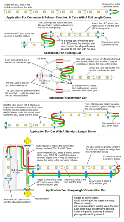

I know I am crossing my hobbies, but there is a lot of information about replacing incandescent bulbs in model trains to strip LEDs. LED's draws less power, you can select a "color", and you can adjust the brightness, depending on the components you select for the circuit.
I am attaching some links with information on the different types of LED strip lights out there and some infoon wiring. These are small enough to fit in a radio or an IP panel.
LED Light Conversion - The End Result
Constant brightness passenger car using 12V LED strip
